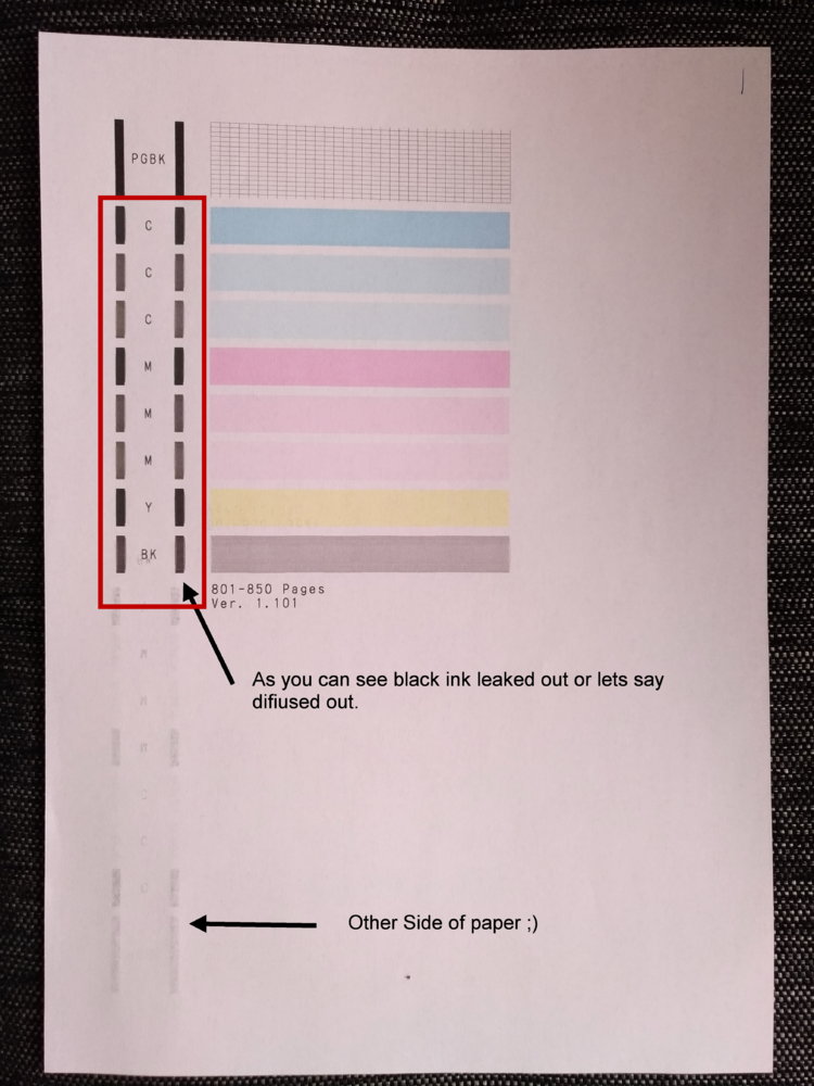

after replacing some original cartirdges, i started to refill them with Inktec ink. as i feared to clog head nozzles i diluted the ink for about 7-8% with inktec Solvent. after a while i found out that my black color fades. i mean when ever printer uses this black color (for example printing water mark on my photos) a shade is appear around the printed alphabet. also if you look at below nozzle check some sort of ink diffusion is clearly visible.

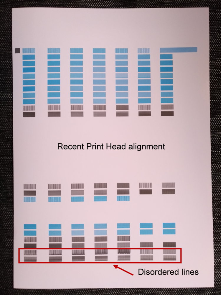

then i tried aligning the head and see some interesting line disorder at the end. (below picture)

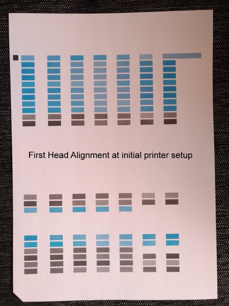

comparing to the alignment pint i've done while setupping the printer (below image), these lines were straight.

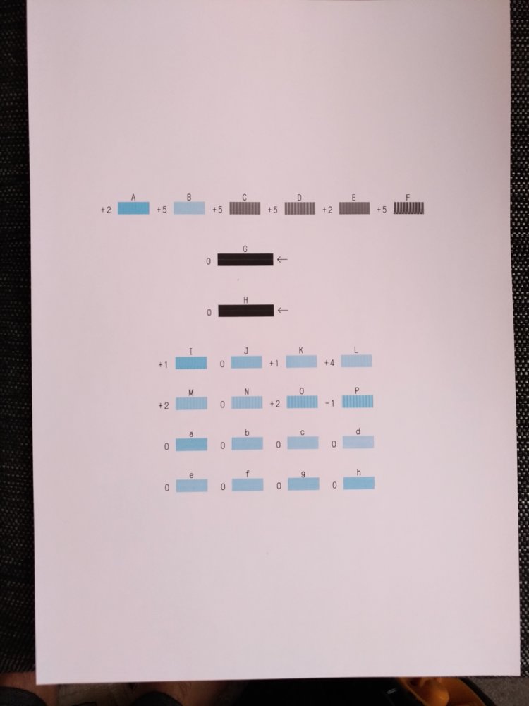

also printing the alignment value as below, every thing seems to be fine.

which inks did you dilute - all of them or only the black inks ? Dye inks can bleed through regular copy paper, that's nothing special, the dye black BK more than the PGBK which carries pigments remaining more on the paper surface. Do you have a problem with edge sharpness on letters ? You may in that case clean the coding strip, a small gray plastic band across the print range in the back, passing through a sensor on the back side of the printhead carriage. Use some kitchen paper or Q-tips like this

The printhead alignment can only be done when the nozzle check is in good condition .

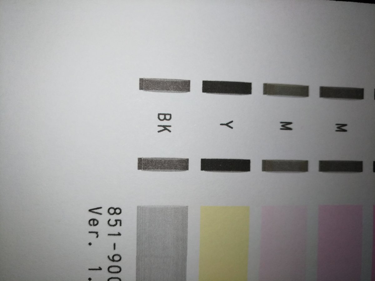

By zooming in on the first picture I think I can see some fuzziness in the two vertical bars surrounding the "BK" letters. This is a print head damage probably caused by an ink unsuitable for the print head. Sadly the print heads of the PGI-x50/CLI-x51 cartridge generation seem to be very fragile in this respect, there have been more reports of this kind of failure. Also PGBK can be affected and show double contour printing of the nozzles at the centre of the test stripe in the nozzle check. Only a new print head can correct this failure, but is it worth it as the print head might be more expensive than a new printer?

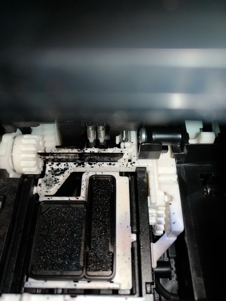

while cleaning the strip i saw lots of fresh int in here below. is it the purge tank? is it normal?

The quality of your photo is OK but sadly it clearly shows that the dye/photo black nozzles have failed. Only a new print head can correct this error. No amount of cleaning either inside or outside the printer will do any good.
The purge unit looks perfectly normal to me, it quickly gets stained from ink in use. Here is a photo from the multifunctional MG5450 that uses a printer part that is similar to the iP7240:
