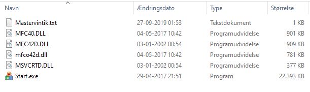

I downloaded the service tool v4718, even if it was more than 16MB and service tools are normally less than 1 MB. The download is a .rar archive which after unpacking contains this:
That Start.exe looks highly suspect to me even if it was accepted by both AVG and MBAM. I think I will test the program, but not on my main computer,

The easyfix link mentions MG3500 series printers as compatible, not MG3600 series printers. The use of a non compatible service tool can cause loss of access to service mode. Maybe it is better to buy a version 5204 that claims to be compatible with the MG3600 series printers? It is only $4 here.
No problem at all, work fine for 2 MG3650, tested this evening.
