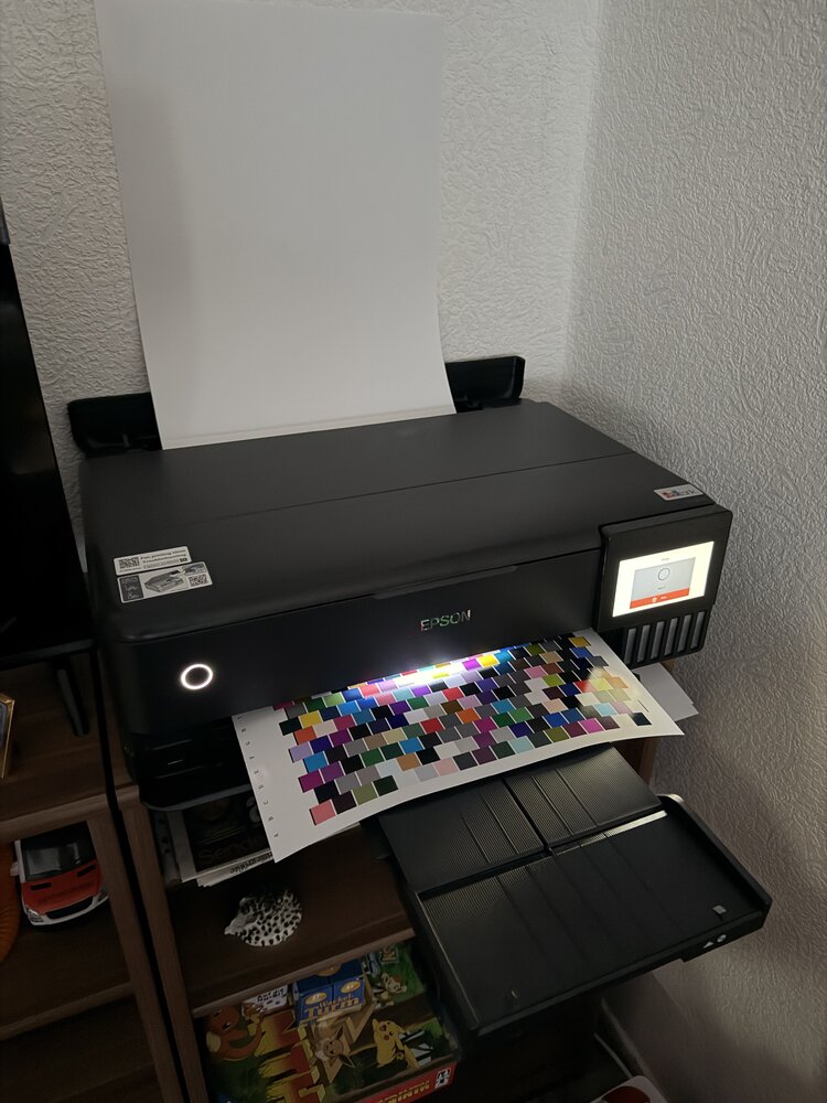

Thanks a lot for putting so much effort into creating this script! I‘ve been using Argyll in combination with DisplayCal for quite some time now but the printer profiling part of it was always too complicated for me.
When I downloaded this script everything was pretty easy and straight forward and I was able to create my first printer profile without any major issues as the script guided me through the whole process.
Since then the script became even more refined and comes with a lot more pre-designed targets for many different paper sizes and instruments.
And when you take the time to learn some things about Argyll it even gives you the opportunity to customize all of the arguments that are used in the process of generating a target yourself and reading the patches. You could say it grows with you.
Thanks a lot! Creating a printer profile was a fun process with this and I managed to get some very nice prints with my own profiles!
