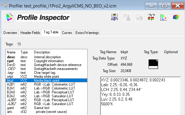

Anyhow, despite the strange, but very good black level on the P900 without a noticeable difference between BEO or not BEO, the conclusion is that the independent scanning with both the Colormunki/i1Studio and the more advanced i1Pro2 gives similar quality profiles.

It's a kind of funny that the black level is improving from test to test - it's now at L=2.25; it's a very good level of the Epson Photo black ink on the Netbit paper. The question remains at which condition - ink - paper - driver setting - the BEO actually does a black level improvement. Or does the gloss look different ? Or is there another effect we currently don't look to ?
It could be coused by Ink-sedimentation . If the Printer was not used before printing the first profiles ,the pigmentet ink descend in the cartridges .Some bigger printer have extra vibrating motors to shake the ink in the cartridges.
Thank you for sharing the results of your experiments. It was excellent (and surprising) how closely the two profiles from two different instruments matched.
I, too, have an Epson P900, yet I'm using all Epson inks. I am not the expert so admit I have a lot to learn. My understanding of the BEO is that it is primarily helpful to reduce the "appearance" of black levels due to the differential glossiness that can occur in large black areas with pigment inks when viewing at particular angles. Without the BEO, those areas at an angle would look a bit duller (less sheen) and have an "appearance" of less black than other less dark areas on the print.
When BEO is turned on, Epson adds a thin coating of light gray ink to the print's black and deep shadow areas to even out the sheen across those areas relative to other areas on the print.
I get the impression that using the Light Gray Ink alone would not change the actual black level much at all, and the BEO effect is more to reduce the differential sheen of the look at particular angles. Upping the sheen in the deeper black areas to better match the sheen in other regions can visually give the appearance of a deeper black. This is also used to reduce the bronzing look that one can get at particular view angles with prints from the P900.
BEO, aka Black Enhance Overlay, sure sounds better from a marketing standpoint than GDR for Gloss Differential Reduction :)
