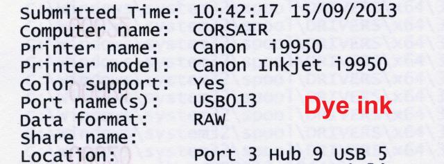

Could anyone post an image of a sample text printout using dye black ink?? Just wanna see before make decision...
I dont know what different it makes to you because there is so little between dye and pigment ink
except for one being water proof and the other is not ..

Many thanks!!
Based on the picture I also see barely no different accept some "stuff" (sorry my English is bad that I don't know the word to describe) in the back of the paper.
The reason I ask for this is that I'm refilling my HP564 pigment black cartridge but...well many problems arise. After reading some hundreds of posts on this forum I decided to have my cartridge purged and refilled with dye black ink to print some non-important paper.
