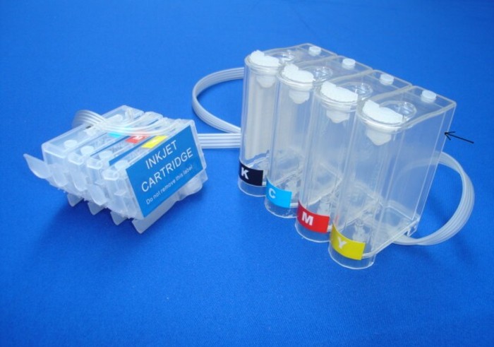

If you want to have a CIS operate with a Canon printer that normally uses sponged cartridges, like the iP4200, iP4300, and similar, then get a CIS that produces a constant effective ink elevation and set that elevation correctly for your particular printer. It is preferable that the replacement cartridges supplied with the CIS do not have sponges. An output filter is helpful, and most have that feature. Proper ink tank elevation will produce the slight negative pressure that the original sponges provide.

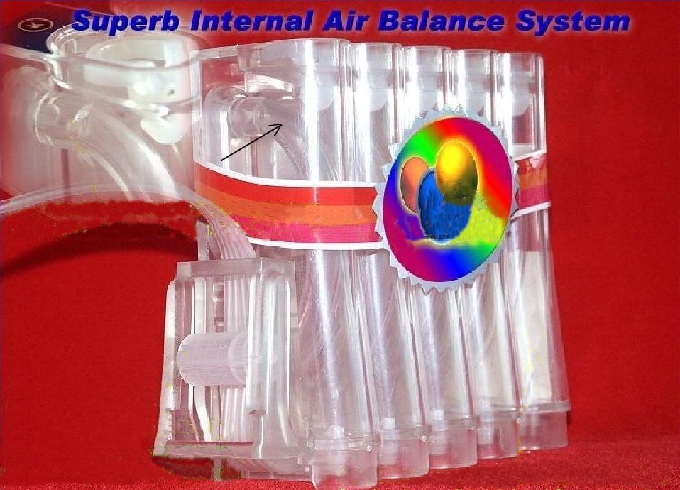

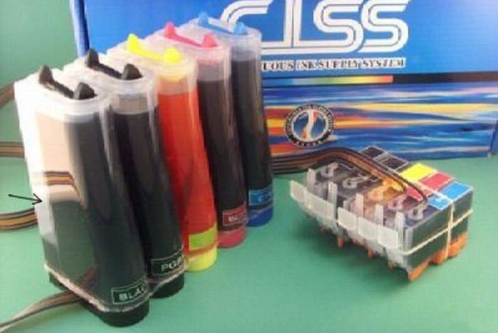

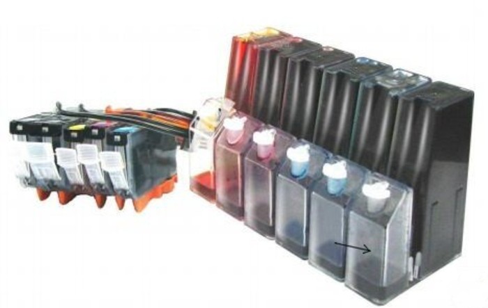

What CIS produces a constant effective ink elevation? See the photos below for some examples. There are probably others, and most sellers don't even know about this feature. In each one shown, there is a special way that the air is vented into the ink tank. It is a variation on Marriotte's Bottle. A black arrow points to the air tube or chamber. The air goes down the air tube or chamber to a point near the bottom of the main ink tank. There the air is allowed to enter the main ink tank as needed. The effect is to keep the effective ink elevation constant at the level of the ink surface in the air chamber or passage.
Click on photo to enlarge. Use back arrow to return to post.
The effective ink level can be seen in photos 2 and 3, just down below the black arrow. For Canon sponged-cart printers, this ink level should be 1/2 to 1 inch below the printhead input elevation. For good operation, raise the ink tanks as necessary to achieve that relation.
The Canon iP4200 printhead elevation is about 2.4 inches above the table. Measure your printer's printhead elevation, subtract 3/4 inch, and set the tanks for the air chamber ink surface to be at that elevation above the table. You will provide the necessary negative pressure required while keeping it from being excessive. When using this approach, you may not need the special seals that sometimes come with a commercial CIS. You could try it first without them. They don't always work well.
