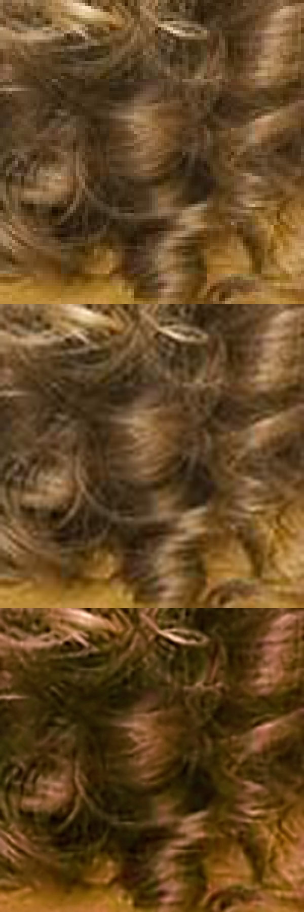

stratman said:
The only question left is whether Qimage's interpolation algorithm (automatic upresolution) is enough to justify using it for printing of my 4x6 to 8x10 single images on single pieces of paper.
I suppose for heavily cropped images that Qimage's interpolation would be useful. Do you find it so? Would you purchase it just for that reason?
I took a 100x100 pixel crop of my granddaughter's hair, and presented it in 3 versions below. To view this comparison properly, you have to load it into Photoshop and display it at "100%" (Keyboard shortcut=Control-Alt-0) to eliminate aliasing errors.
Top - upres'd to 600 pixels using "Nearest Neighbor" in PS. This is what the Canon printer driver does when it is sent an image at other than 600 ppi, and is what would be printed if the image wasn't upres'd before printing (typical of most people's workflow).
Middle - upres'd to 600 pixels using "Bicubic Sharper" in PS. To make a "best case" comparison, we have to assume that you would upres each of your images with PS if you did not have Qimage.
Bottom - upres'd to 600 pixels using Qimage's "Hybrid" setting. Note that the color is slightly different in this one because it was processed through my printer's icc profile (because the file is meant to be sent directly to the printer). Upres'ing an image in this manner is transparent to the user once the program is configured.
Clearly, the middle and bottom images are better than the original - I leave it to you to judge which version is better. Since you have already downloaded the Qimage demo, do the same test on one of your own photos, printing the original (low res version) directly to Qimage and PS and then upres'ing and printing through PS (with all 3 versions printed at the same final print size).
Note that there are other interpolation programs that claim to be even better, but I have no experience with them (e.g. http://www.ononesoftware.com/detail.php?prodLine_id=2.

Qimage does improve output slightly over Photoshop's bicubic sharpener in your example Grandad35. I need to try your printing challenge.
