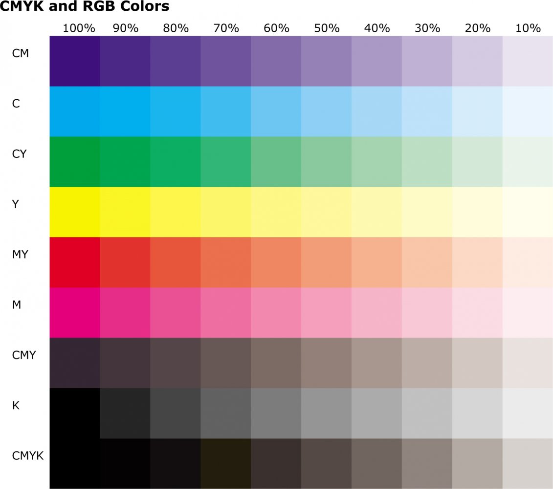

The easy refill route is not always the best refill method to use, so shortcuts should be avoided and if you fail to refill correctly the first time then try again, it’s better if the cartridge fails outside the printer then in.
Most 3rd party refill carts are just about the easiest carts to fill by a country mile, that’s what makes them so attractive, but they are also known not to give good continued ink flow when you need it most, which in turn can end up costing more than your printer is worth (Replacement print head)
If you have a problem using the German refill method then just switch to the top fill method till you can get the hang of the German method later, switching back is also very easy.
Here is a test print that will determine whether your cartridges are delivering sufficient enough ink for any photo you may want to print and not risk losing your expensive paper if it fails.
When you’re ready to print and have a good nozzle check then print just 3 of the test prints on standard quality and plain paper if they print successfully then your cartridge are working perfectly..
View attachment 2438 copy and save to use later..
