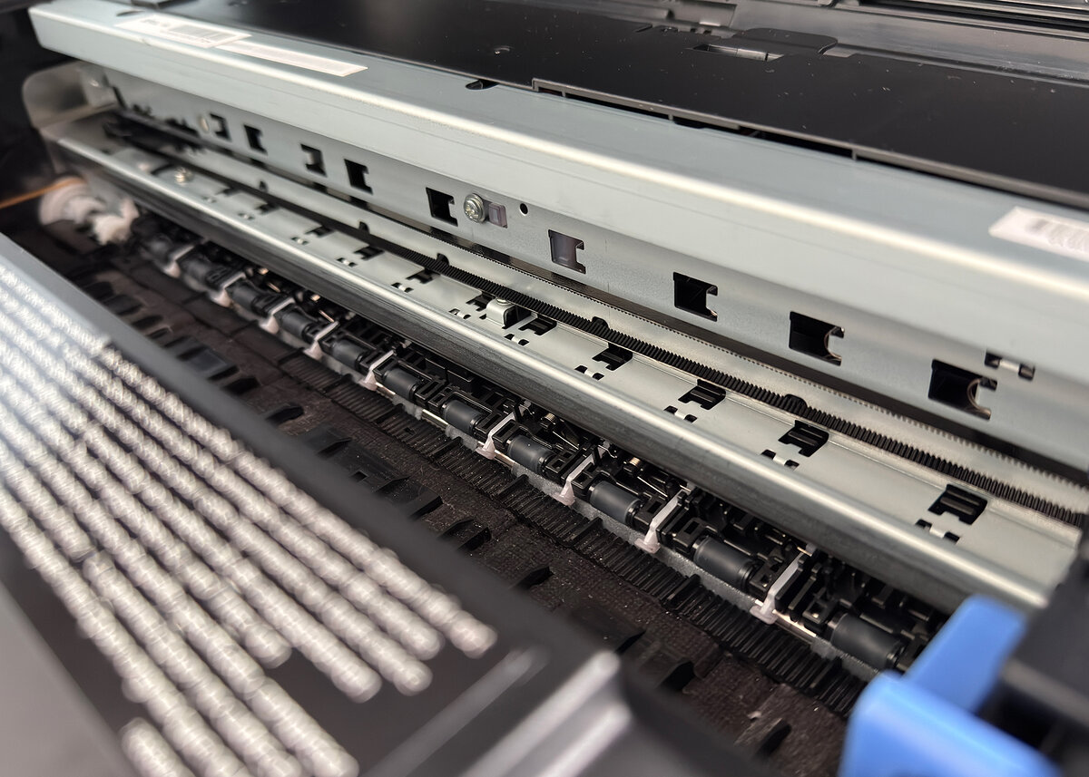

I was wondering if it is possible to re-lubricate the carriage guide rail on my ET-8550?
If it is possible, I have two main questions:
  1. What type of lubricant is recommended
  2. What is the best application method?
Any tips would be greatly appreciated, thank you!

There are sites which can download pdfs from scribd. This one for example.
The lubrication section starts on page 161. The carriage rail needs a little under 2g of Epson G-97 grease which looks like it is white lithium based probably lower viscosity than typical and possibly with added PTFE.
There is a diagram showing where on the rail it needs to go, but, not much useful instruction on how to put it there.
