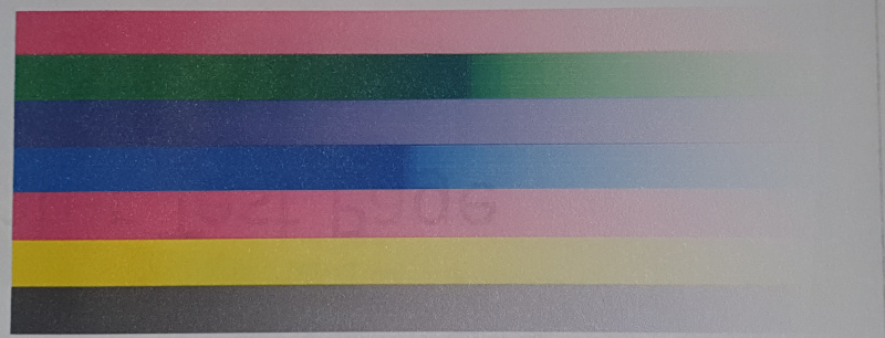

Overcast sky, white balance corrected. My print shows green tint and strong blue. Is that something that can be corrected with colour profile or I should keep exploring the settings and gutenprint manual?

- heavy banding (*) on blue (also green, but that's probably from blue) - middle of the test strip i the darkest point!
I tried RGB and CMYK in print window with mixed results. CMYK gives less banding, but producess green tint.
(*) I don't think I used the word correctly. I wanted to say that blue gradient going from full saturation to white has a glitch in the middle. View attachment 10316
For future reference: the problem was related to gimp colour profile conversion from Adobe RGB 1998 to GIMP built-in sRGB, not to cups/gutenprint/colour model/dithering method/colour correction.
P.S. Please do not assess the quality of the print. I'm waiting for propylene glycol :)
