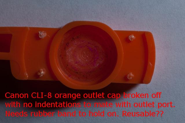

Here are some images:
Note that the starter kit I received had larger caps, which I suppose are for the black cartridges of other printers.

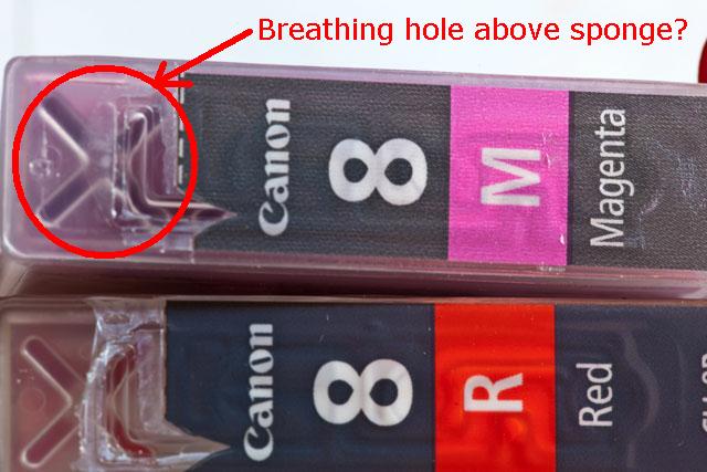

You should notice that using the top refill method, one should always tape of the breathing hole above the sponge area very tightly when the ink level is about 50 % and continue ot refill up to 100 % and then seal. This will ensure the cartridge will reach the necessary sub pressure level. If you just fill up to the tope, the sponge will become oversaturated and this will cause dripping and even banding during printing. So too much ink will cause banding !!!
Another alternative is to milk the cartridge (pushing the cartridge wall together), so the sponge can loose 5-10 drops of ink, but this will put pressure on the cartridge wall and will wear out much quicker.
Is this the area you mean? If there is a breathing hole, it must be pretty small. I suppose it is part of the "serpentime labyrinth"?
I looked a little closer, and there seems to be some tape/cellophane material covering the area that resembles the X. You can just make it out in the upper Magenta cartridge. It seems to be under or part of the black tape with the Canon 8 on it. I wonder if it is sealing the breathing hole?
