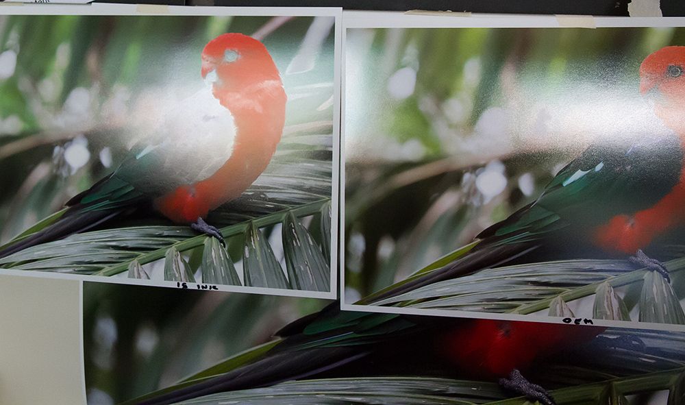

Here's the bronzing, it's hard to show in a shot but you can see the difference of how the glare is more even across the colours with the OEM ink shot on the right.

Do you find that all colors directly or indirectly affected by the Magenta inks show more of the bronzing and gloss differential? Or are there other colors as well.
I have found that both IS and OCP pigment magenta inks both light and regular, seem have a very low gloss to them.
