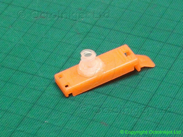

Sorry, but the drip system seems to me an unnecessary loss of time. Refilling a totally empty PGI-72 requires pouring 250-300 droplets of ink, one after the other. You can’t do that in a few seconds. unless you don’t mind overspill, stains and mess. Using a refill plug and a syringe takes 9 seconds ( I’m a tad faster than @The Hat.. :p )
Yes one has to clean syringes and needles afterwards but, altogether it takes less time than with the drip system,
My method for PGI-72 cartridges:
1- Weight the cart. with the bottom clip on, to know how much ink I’ll have to inject to reach 33 gr. ( 14 ml of ink=15 gr. except Chroma optimizer which is 14 gr)
2- Remove bottom clip. Reset.
3- Insert the refill plug, fill the syringe with the required amount of ink and refill the cart upside down.
4- Remove refill plug; insert regular bottom clip. Weight again to check if we’re in the ball park - 32.5-33.5g is OK. (1 gr less for CO )

My scale is not calibrated (either ?).
I used to fill without clip (=2g) to 31-31.5g.
Without clip the cart is filled to the rim at 33g.
It’s looks like I’ll have to pass the hat onto to you as the fastest refiller.. ;)
The dribble method is out of the question when filling 20 or 30 carts at one time..
7,176
Are your cartridges OEM or aftermarket?
If OEM, please post a link to instructions on making the plug hole and where to purchase plugs for fellow forum members.
