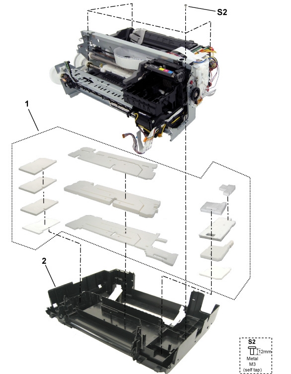

The two pads in the picture uploaded by The Hat are not waste pads, they are purge unit pads and their purpose is to distribute vacuum evenly under the print head nozzles when cleaning the nozzles. They are made from a hard and porous plastic material.
The waste pads or ink absorber pads are much larger pads made of a felt like material, and the pads are installed inside the printer case at the bottom. Ink sucked out from the print head during print head cleaning is deposited in these absorber pads.
See this drawing from a parts catalog for Canon Pixma iP5200. The absorbers are marked "1".
That's a LOT of waste pad! And now I see why people talk about them being impossible to replace.

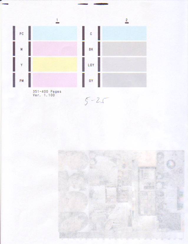

Now here's something interesting I didn't notice before; maybe it's a clue.
Once a week, even if I don't have time to do any real printing, I print a nozzle check then a 4x6 test image, to protect the print head. This was done on May 25. I didn't even notice those black blobs at the end of the sheet of paper! They're slightly darker on the side with the nozzle check so that would have been the first part of the page to come out; in other words, the first paper that came out of the printer in about a week.
Does this mean anything to anyone? (By the way, the 4x6 image on the other side of the paper doesn't have any unusual blobs or colors; it's just really absurd color because it's plain paper.)
Are you sure you used PM instead of M in the refill? PM looks too similar to M to me (although is could be a scanning issue).
