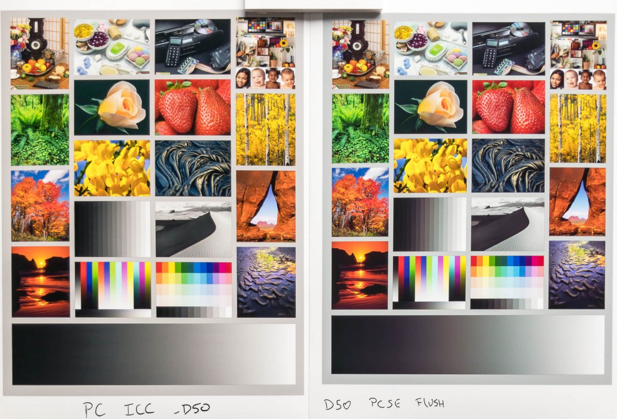

Hello,

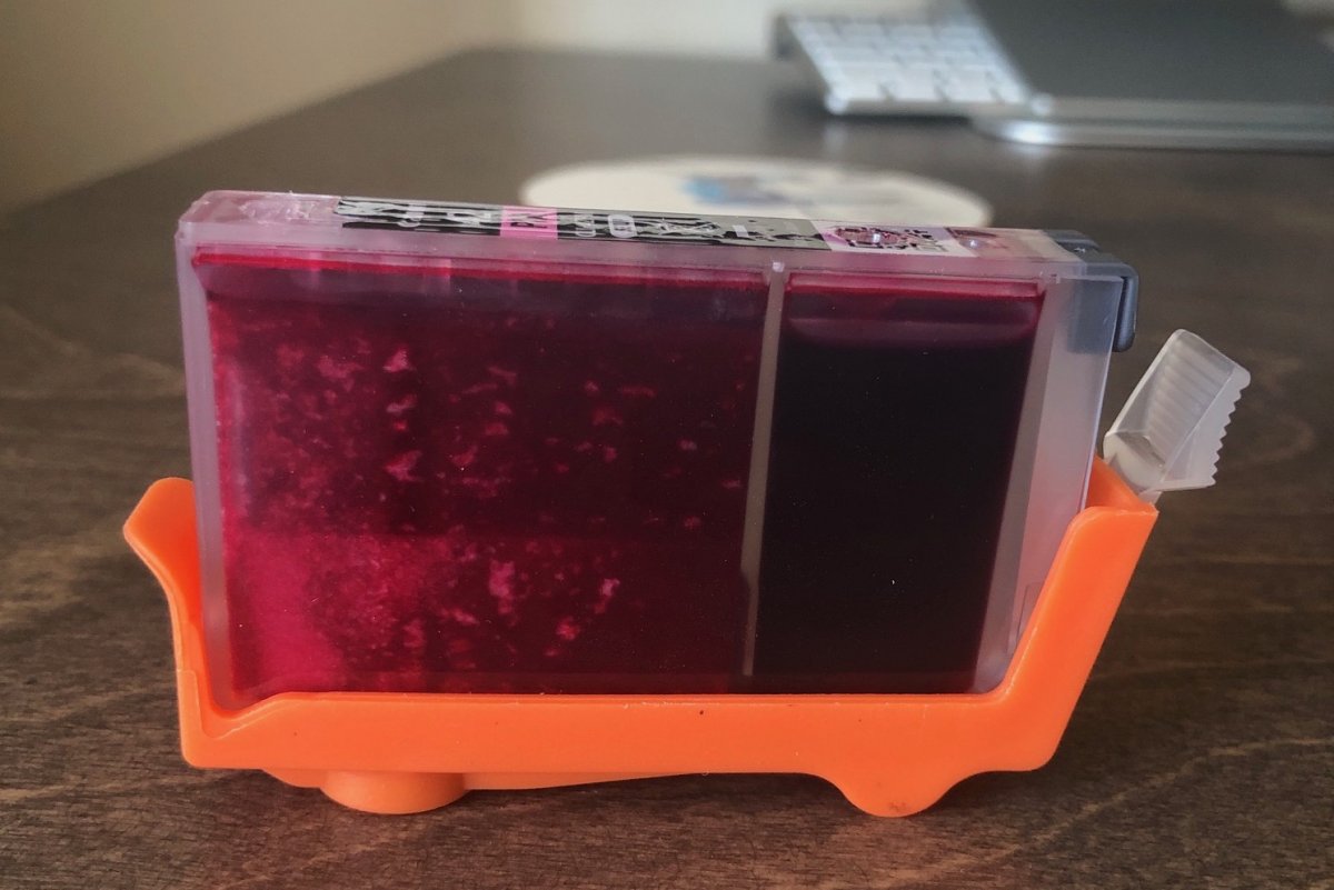

I am having this color cast (right pic) with greys on my Pro-100. I tried to read the RGB values of the photo of my print, and it may be that G is less than the equal R,B. I am using PCSE inks with OEM carts and supplied yellow cart. Recently I was having other issues, in order to eliminate that I inadvertently crossed C/PC & M/PM, i flushed all four and refilled with PCSE. (The PM cart wouldn't fully saturate the bottom sponge but decided to use it as I await order, probably has some water still in it)
Nozzle check, alignment test, cleaning all ok, less than 300 prints, 2yr old Pro-100.
Any ideas what could cause a grey pattern that is not neutral and any suggestion to isolate the problem? Previous to this round, PCSE provided excellent greys (left pic). Thank you!

@The Hat , thank you, I welcome any advice. I wasn’t rushing, maybe nervous the first time I refilled which caused mistakes?
When I flushed and refilled, I did take my time (6d in total). I did the process three times for the M cart as I couldn’t understand why the bottom sponge wouldn’t saturate. Reading another thread here showed that the member drove air in to help the ink migrate better.
I can’t say it was bone dry as it was 13.8g and compared with the other 3 carts that I refilled at 13.65g which were ok. The top sponge saturated bcoz the ink quickly absorbed and migrated towards the top. I will redo the procedure but wanted to join and learn here in case I was repeating the same error in my flushing/refilling procedure.

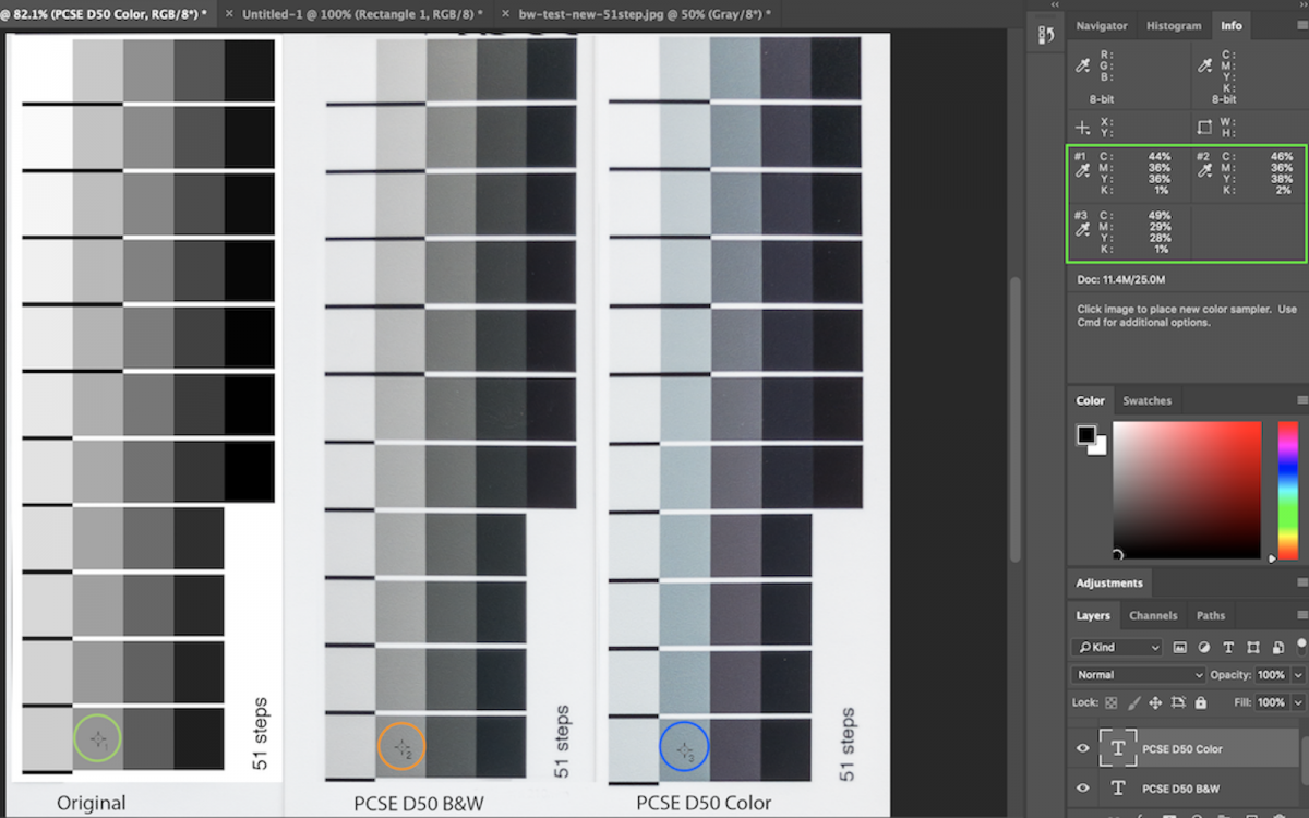

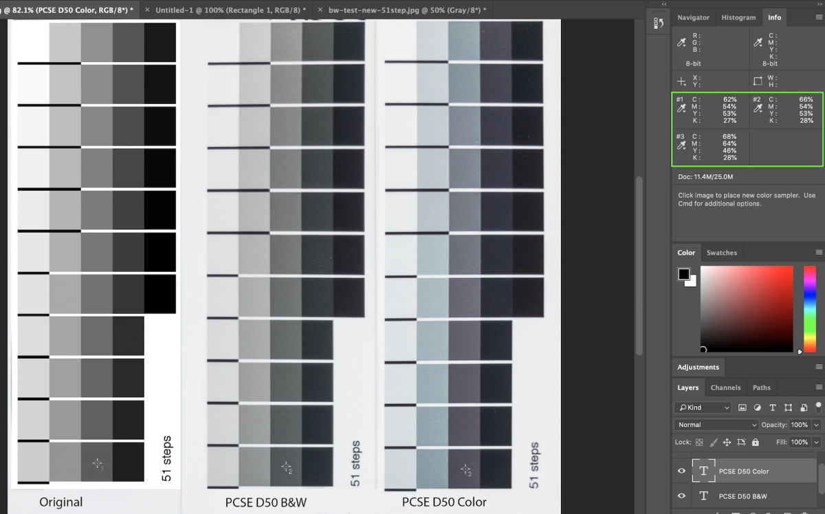

fyi and to keep my progress tracked here. PC suspects I may have mixed grays during refill, so my next action is to flush GY, LGY and re-check. I am filming the refill to eliminate doubts post refill but wont do this just yet as I just topped all my carts. In the end I would have flushed all OEM carts except BK & Y (from PC).
Learnings/observations:
1- It seems even when B&W printing, Pro-100 still uses other colours than GY/LGY/BK carts
2- Grey in CMYK is presented by equal amounts of M,Y.

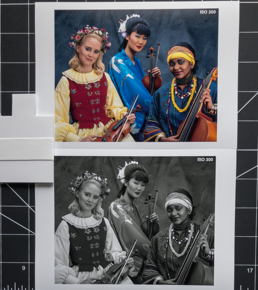

3- Printing a B&W image using B&W printer setting using PC ICC yields good neutral results for both patterns and photos. (Last pic attached)
4- I printed the same photo of the 3 ladies in color & B&W, in person the colours are stunning!
(3) may indicate that I did not switch any of the Grays ? My analysis of the grayscale pattern strips not using B&W setting yields some different shifts, some more towards Cyan and some other towards magenta/red.
Attached are a comparison of the 51grey steps: left is the original tif img, middle is B&W settings print, right is color print setting from Pro-100, adjusted as much as I can to match WB/exposure/.... In the screenshots, upper right hand, color sampler shows CMYK for a point in each img which I summarized in the tables below.
Table 1: M/Y under
Step 22: Cyan castCMYK
Original4436361
B&W Print4636382
Color Print4929281
Table 2: M over, Y under
Step 33: Magenta castCMYK
Original62545327
B&W Print66545428
Color Print68644628

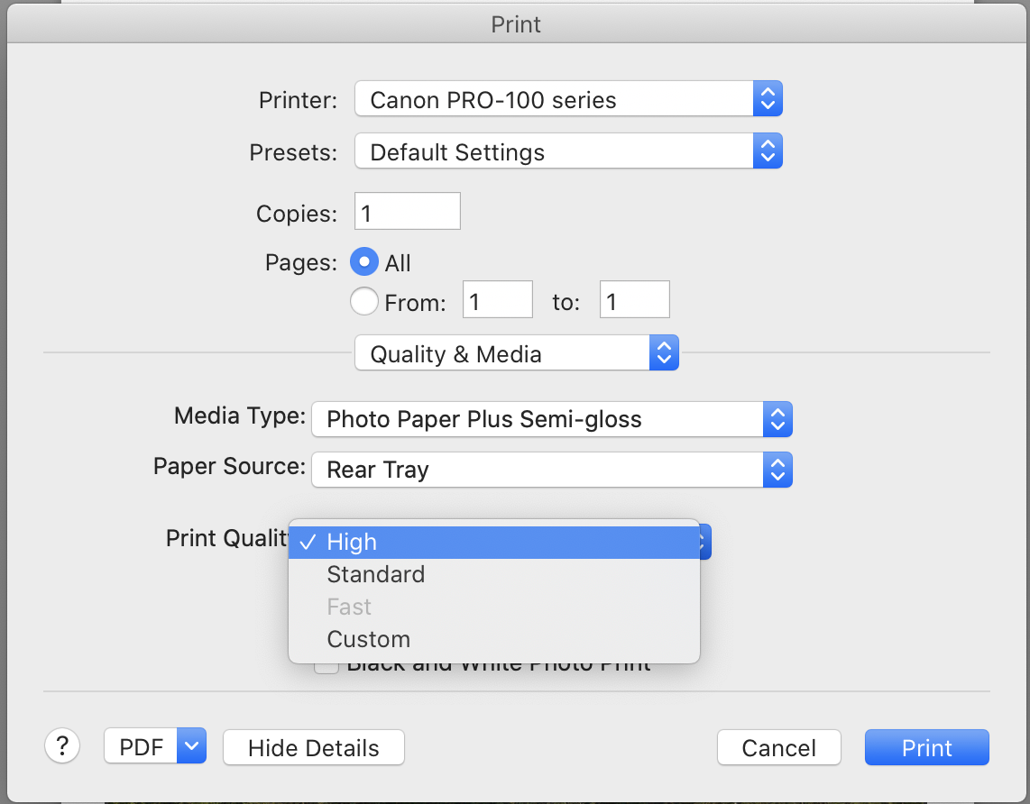

I am speechless, after months, 100 test pattern prints, many flushes, refills and ink wasted it all boiled down to one darn silly setting: Print quality setting. see photo...
It is easy to reproduce my issue by printing any grayscale test pattern using Standard and High print quality. :he
