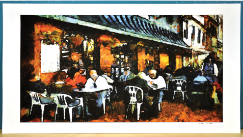

@jtoolman, I reckoned your print of the Café scene you posted on here some time ago was a real special, so much so that I included in this years Calendar, I do one every year for the misses to write dates and times on..
View attachment 3421:thumbsup
I agree. Not only does it capture the informal and relaxed atmosphere of an outdoor cafe, but is an excellent example of appropriate use of the watercolour paper for maximum effect.
Bravo Jose.
