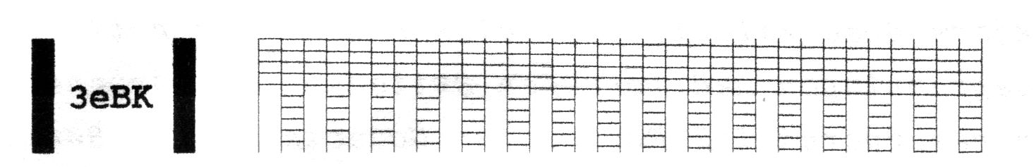

I use my Canon PIXMA 3000 under Linux Mint (Isadora). It worked perfect until recently, when pictures looked pixelated to some degree. When running the nozzle check, the pattern looked systematic as shown below (vertical lines were perfect and omitted here)

In any case I repaeted several deep cleaning circles, but without succes.
Could somebody give me a hint??

Sorry, here is what I could get.

You have several electrical problems that cannot be fixed unless they are caused by bad connections between the back of the print head and the contacts on the carriage. Try removing all the cartridges and then the print head and then reinstalling them. It probably won't help. You need a new print head. You have a problem with the top half of the light cyan and the top half of the light magenta, as well as the patterne of missing segments in the pigment black.

My older printer showed a very similar nozzle check, at the end I had to discard it because of electrical problems.
In my case: I changed some cartridges, checked the electrical interface between the printhead and the printer itself and ran a thorough cleaning of the printhead without any success at all. Some groups of nozzles were kaput, the same as your case. It forced me to print in high quality in order to avoid banding. After some days all the colour nozzles went off. :-(

I checked the print head connections, but without any succes.
Thank you everyone for qualified comments.
In conclusion, its a new print head (rather expensive) or a new printer.

Sometimes it's a gamble getting a new print head since the printer itself could be bad. Or even worse, it's been reported here is that the printer will destroy the new print head.
