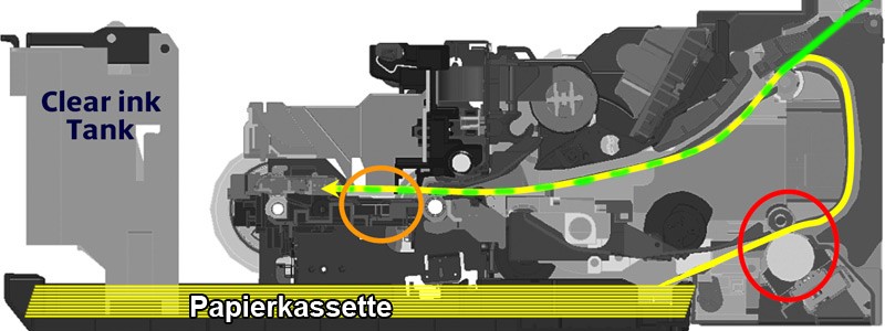

The German test that Ink stained Fingers posted, linked to another test of MX7600 printer that had a very nice picture showing how clear ink is deposited:

The German test that Ink stained Fingers posted, linked to another test of MX7600 printer that had a very nice picture showing how clear ink is deposited:View attachment 4252
