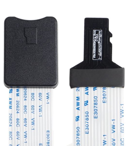

I’m still on the fence regarding Wi-Fi, and don’t like the idea of trusting it while running the 3D printer, there are too many things that could interfere with it, I use this instead and have learned to live with the micro card, plus I get more exercise moving between the keyboard and printer.
Capture.JPG click to enlarge.

You don't need to trust wifi if you use Octoprint - it's just used to transfer the STL file to the Raspberry Pi's SD card. The print itself is controlled by the Pi via USB (or, optionally, from the printer's SD card) so wifi problems or PC reboots won't affect the print. By the way, I also have one of those microSD card extenders. I designed a simple holder for it:
https://www.thingiverse.com/thing:2159505
That looks good. It certainly would have made it easier to move the SD card to and from my motherboard. It's not that easy to access the SD card slot on mine. This was one of the reasons I didn't like using an SD card as the transfer mechanism.
I started to use the Microcard extender because I too found the MC slot on the printers were a bitch to access, I download your Microcard holder and am going to use it shortly, thanks @ninj.. :)
