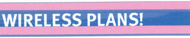

Whoa! How did this happen? I looked at all the colour carts and only the magenta tank seems empty (but the chip says the cart is 3/4 full) However, it seems that the cyan is what's missing but there's plenty still in the cyan.
Here's a scan of what's happening:
And here's what it should look like:
My printer is an MG6120. On my last printer I needed to do a cleaning because of this sort of nonsense. I was of the mind that this printer did that automatically. And it is the firmware that handles that, right? I printed this from Linux so if the onus is on the driver, maybe that's my problem.

Looking at your scanned image it has all the hallmarks of ink starvation in your cartridge
and nothing at all to do with cleaning the print head because that wont solve the issue either.
The problem is with your cyan cartridge or precisely the way youre refilling it,
and going by your statement above would confirm this as an ongoing refilling problem with all your cartridges.
I have no idea which method you use to refill your cartridges or which type of cartridge your using at present
so I would suggest you re-examine your procedures once more to see if you can correctly identify where its all going wrong for you.
Change the problematic cyan cartridge for one the you know for sure is working properly (buy a new one if necessary)
and run a normal head clean then print a nozzle check to see if that brings back the cyan for you,
repeat this procedure once again if need be.

The banding of your posted test image implies to me that one color is not being printed in one direction of printhead travel.
Does the appearance change if you select a higher or lower print quality or a different grade of paper in the driver, so that printing is only done unidirectionally?

I topped up the magenta, put in a different cyan, did the cleaning (colours only) and the nozzle check. The nozzle check worked fine. I then printed the brochure again and that went fine, too.
So I don't know if it was the replacement cart, the cleaning or just the fiddling w/the carts or trying it on another day. What should I do next? What about the cyan cart that's half full?
