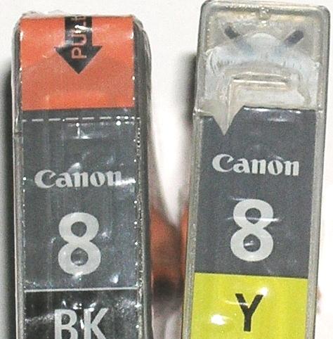

Does the brand new cartridge that you purchased from Canon comes with the seal tape at the L shape opening? If the whole maze mechanism is just merely for cartridge breathe during the daily air pressure cycles, then canon would have packed it without the vent tape when they sell it.
Yes, if you remove the shrink-wrap plastic around the entire brand new cartridge, the seal tape over the air vent L shape opening remains intact.
I answered the question of why Canon seals the air vent here:
http://www.nifty-stuff.com/forum/viewtopic.php?pid=46892#p46892
The seal tape that I mentioned at the L shape, I am not referring to the black tape above the maze that covers the maze and center vent hole. But rather the orange pull tape that also seal the L shape opening. Once you pull this orange seal tape, you open up the L shape vent area which leads to the long maze passage to the center hole. So once you the pull orange seal tape, it is removed and does not remains intact.
The shrink plastic wrap the cartridge. And it does not remove the orange seal tape unless you pull the orange seal tape. Because the orange seal tape adhere on Top of the cartridge to seal up the L shape opening. When canon ship their new cartridge, the L shape opening leading to the center hole is sealed such that no air enters.
However if you pull the orange tape, it remove the both the orange tape and shrink wrap plastic altogether.

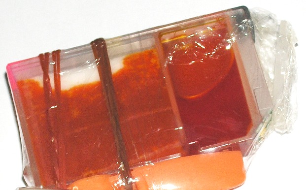

ghwellsjr, by the way, this is one of Y cartridge that had been opened and use partially few years ago which later on the same day the were opend, were stored until now. Both the air vent (from L shape opening) and exit cap is sealed and then wrapped with a sticky plastic (this plastic has a similar feel to microwaveable plastic wrap). Then placed inside a tupperware during those time when I was storing it.
I did not experience any leak at all despite I had both air vent and exit port sealed when I opened it 2 weeks ago. The sponge in the sponge chamber is not even oversaturated.
(Just to point out, in the above picture though you see me securing the exit cap using rubber band (because that was done long time ago). If now, I am going to hold the original orange cap onto the cartridge for which I had intention to store for a long time (say a few several years), I think I will not use the rubber band directly on the cartridge anymore. Because last time, I found one of the rubber band which I used to secured a spare cartridge exit cap that I did not use for quite a long time, sticked to the cartridge).
http://www.nifty-stuff.com/forum/uploads/2740_p1013259c.jpg
Yes, I understand all that. I removed the shrink plastic wrap by cutting it off down near the orange cap and it leaves the seal tape over the air vent L shape opening intact. We have the same understanding.
http://www.nifty-stuff.com/forum/uploads/2740_p1012993.jpg
I can do one test with the orange cap held in place with a couple rubber bands and another test with it held on by whatever new method you want to choose, plus I'll do one test with a piece of the yellow vinyl tape that I normally use. Any other ideas?
