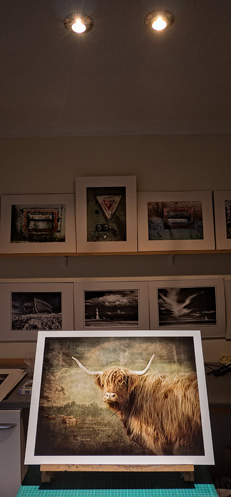

I have them as ceiling mounted downlighters to give me a reasonable "viewing area". With this arrangement the print brightness is a near perfect match to my monitor brightness (120cd/m2). This is how it looks with an A2 prnt.
I like the print for starters, has a really nice classic"feel" to it.
Do you have this lighting set up to illuminte the entire room, or just one specific area?
Added : How far above? my ceilings are a nominal 2.8m approx
This is a terrific thread, as my "proofing" is at times somewhat drawn out. It has evolved over time and relies now on my calibration being spot on. I have thought, rather than sought, to resolve viewing/ lighting set up to get quicker results.
For me 12 hrs drying is cast in stone, as are the time of day i print. My workflow is driven by the need to get natural lighting at the same or similar levels to the prevailing lighting when i made the profiles. I have time to wait. But what if that is not the case and commercial needs drive a persons work flow .....so we get back to lighting.

Yes, the print is very nice. Unfortunately it's not my work; it's by a very talented photographe called Pauline Fowler http://www.paulinefowlerphotography.com/ Wish I could do something nearly as good!
The lights are intended to illuminate just a relatively small area - about 600mm square. The ceiling is 2.5m high so the lamps are 1.6m above the work table. I run them from an electronic transformer that gives a bit less than 12V so the measured colour tempeature is 4400K rather than 4700K. Makes no difference in pratice.
