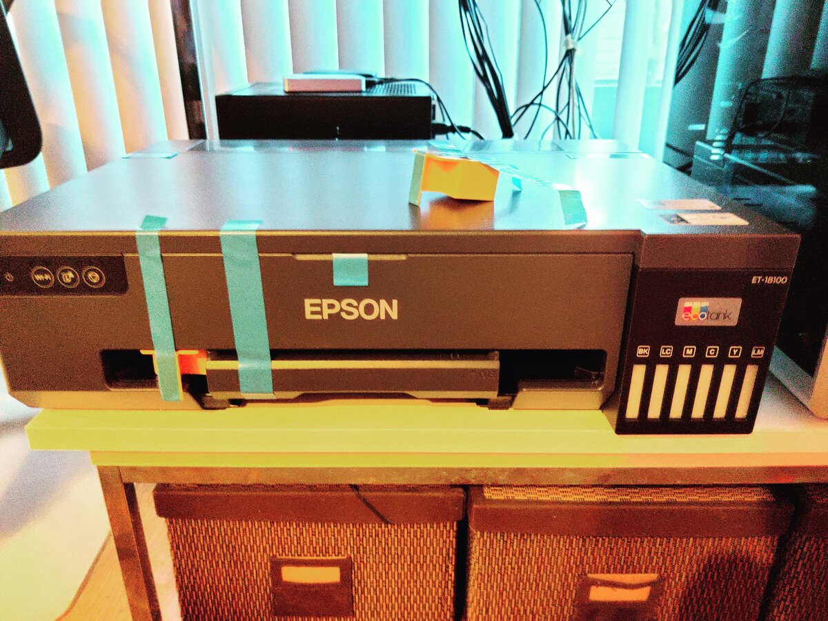

I have bought an Epson ET-18100 (L18050) printer, mainly for the PVC ID card printing capabilities and the CcMmYK 6-color printing engine, similar to previous Epson 1500W A3+ printer that only used tiny cartridges and did not had a user removable waste ink tank (I used a Printer Potty to redirect the waste ink during cleaning cycles into this external container).

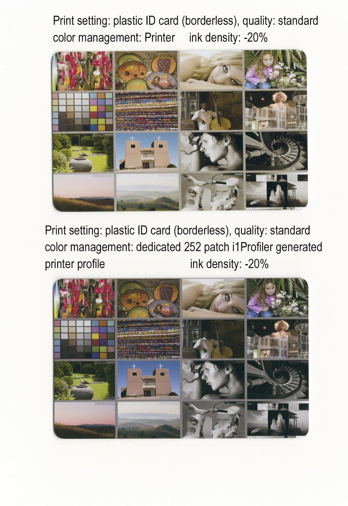

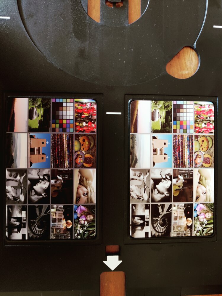

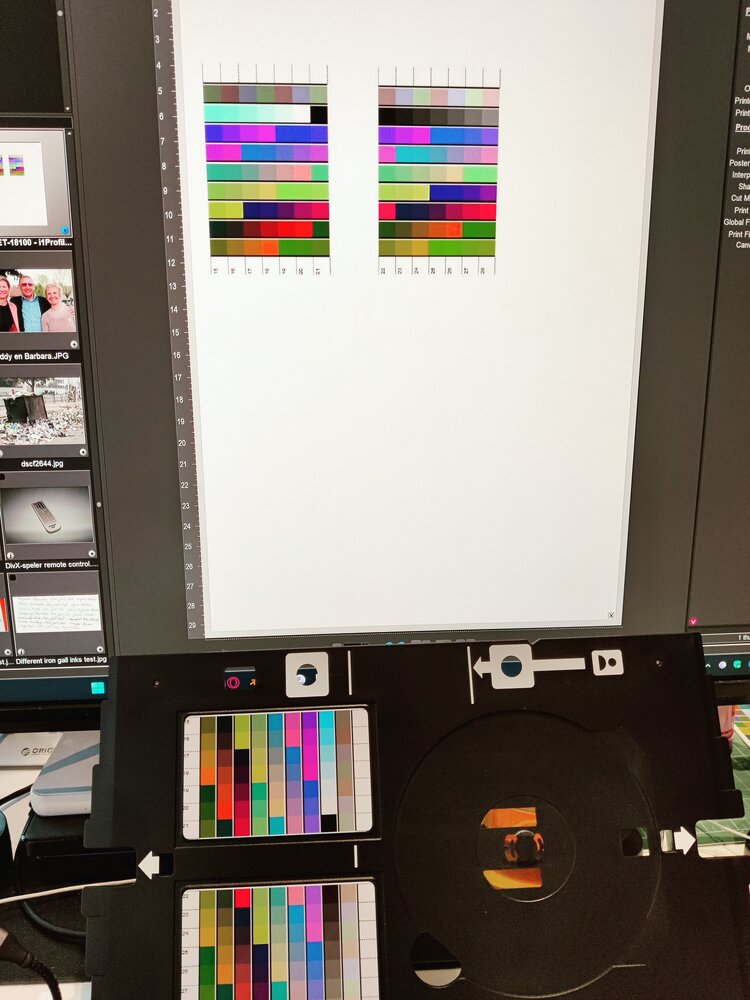

To generate a PVC ID card target I had to download a PSD template and pasted my targets on this template.....The first try was not a succes: too much ink (pooling) was laid onto those PVC ide cards, so I have to reduce ink intensity with -20%. So printing wit color management: OFF to print the targets.....
