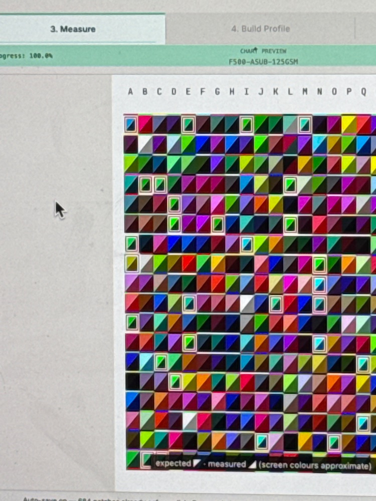

I’m using ColorMunki Design and ChromIQ to create an ICC profile for glossy white aluminum sublimation panels.
I printed 700+ patches with ChromIQ, and 40 of them came back with a red border. When I tested the profile, it said “needs more work,” and ChromIQ told me to refine one of the patches.
I have a few questions:
1. Do I need different color patches specifically for sublimation?
2. How many patches is ideal — 100, 300, or 1000?
Thanks in advance for any advice!

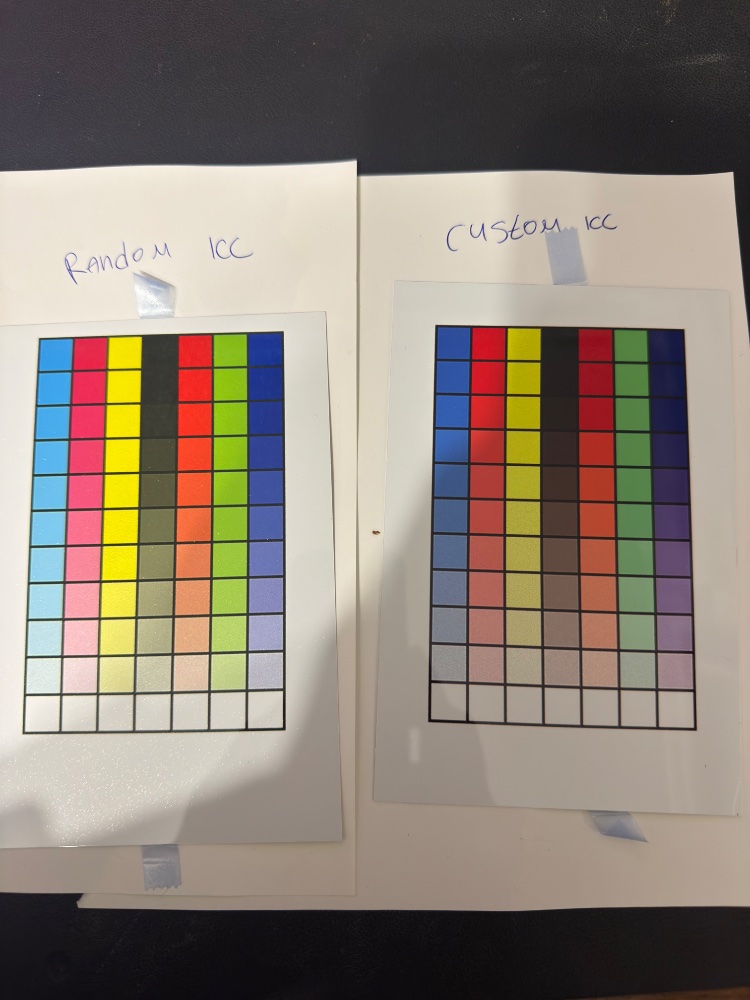

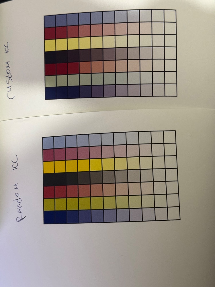

I created a custom ICC profile, and ChromaIQ reported it as excellent, with only three colors showing a Delta E above 2 — so far so good. However, once I started printing, the results were very similar to what I get with a random/generic ICC profile. Additionally, my yellow areas are showing red dots/specks.
Did you use perceptual intent + black point compensation=checked ?. Your yellow showing red spots are caused by contamination and had nothing to do with the the profile itself (probably some incidental leakage from the magenta nozzles on the yellow).
I checked Black point compensation and for gamut source is Perceptual + Saturation
