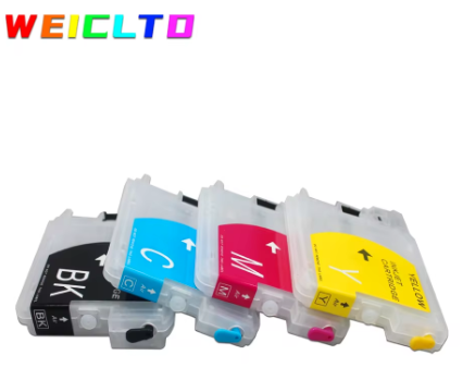

Hello, for my MFC 5895CW 4 color brother printer I need good colorfastness ink for photos.
Tried the epson T673 printer prints perfect nozzle check then 3 pages graphics A4 then nozzle check randomly disappears.
If I lift the front of the printer up a little the nozzle check after clearing is perfect again. So seems ink flow problem.
I use these carts image attached. Carts are new.
Gemini says that epson T673 ink viscosity is too low and I need to use Epson T26 ink that should be better. But that is not logical. Ai says ink simply backflows into carts sucking in air.
Any idea for better ink from bottles I can use?
You get the best light fastness with the OEM Epson inks 106 or 114 for the ET-7750 or ET-8550 - these type numbers may vary in your country. I did refill with these inks longer time ago on Brother MFC-585.
