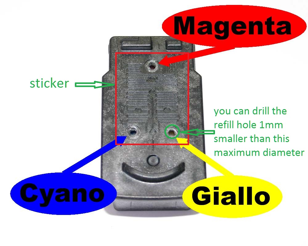

How did you refill the cartridge? Drilled holes like this: http://www.stampantieplotter.com/wp-content/uploads/2012/07/Colori_Canon_CL541.jpg ? If yes, then you can make them a little bigger, say 4-5mm in diameter, and check the sponge with a flashlight as you refill (single led and zoom capabilities is the best). Always place the sticker back on the cartridge in the right position after refill.

yes... i drilled holes like that
the kit i got didn't come with an adapter kit - i've seen others that came with a clip - what does it do?
the kit instructions said that i should worry about the holes - so i left open
(they do give some tape to cover the holes)
4-5mm sounds massive :)

If you don't put the sticker back over the maze and holes the sponges will dry a lot faster and they will take in less and less ink.
4-5mm is not massive at all, as long as you cover the maze and holes with the sticker. The idea is to see the sponge while you refill. But don't make it larger than the indentation!
Regarding the clip, if you had it you wouldn't have to open the cartridge to flush it. The clip is used to suck a little ink from the printhead/cartridge after refill and before installing it in your printer.
