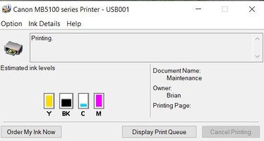

I’m having great fun with my Maxify printer, it developed an error with the magenta cart some time ago and I haven’t been able to cleat it since.
It won’t recognise the magenta cart, despite changing it several times and ending with a brand new cart but still I get the same error, I’ve even made sure that all my chips are OEM so there can’t be a mismatch..
Any ideas ?..

All’s good again now, I held my patience with her and tried one last time.:barnie
I removed all the OEM carts after pulling the plug in the middle of start-up, deliberate on my part, to force a different kind of error from her, then left her turned off over night with no carts in her.
This morning I put in another set of carts with compatible reset chips and sure enough I get the message that I hadn’t turn off the printer properly and to press OK to proceed.
She went through a huge cleaning cycle and then paused waiting on a print job, so I gave her a few nozzle checks followed by 10 sheets with text and photo on, and now she’s like new again..
I don’t think she knows how close she came to propping up the waste bin lid.. :lol:
Here’s her status now..
