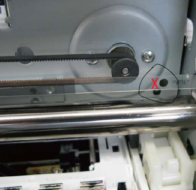

Back to my mx700. Hat said "don't give up on it". I remembered different threads mentioning a knocking sound
but no solutions. I have the same thing for 30 seconds after the print head cycles. What problem does the knocking indicate?

It maybe that your timing strip has either got dirt on it or has fallen off the holding clips, this strip is used to tell the printer where the print head is at, so that maybe that's the source of your knocking, it’s worth a try.. :confused:
Thanks Hat,
The timing strip should and does look clean. The sequence follows:
Print head from center moves left then cycles 3 full passes without knocking.
Pauses at home to right, starts cycling again and knocking also the black and yellow cartridges flash red.
Print head stops at center and continues knocking and flashing for 15 seconds.
All stops
