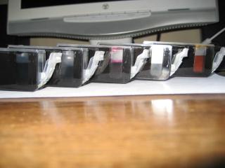

ok i picked up the printer from the techs and they said the usage was normal and the cleaning cycles were normal, so i will print in fast mode unless doing photos, if someone knows how to get into the service mode i will see what the printed pages have been and post a pic of the cartridges for the amount of ink used, well i'll post a pic of the carts anyway and guess at the pages as they are under 30 total, pics coming later today
