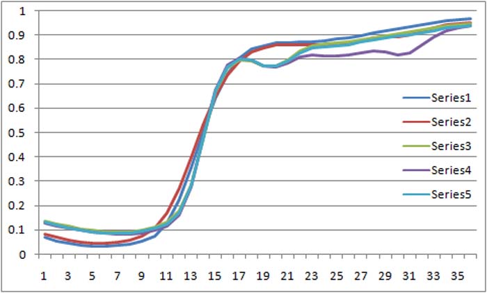

I would like to request an addition to your graphs. Could you please have a graph for each color which overlays/superimposes all the aftermarket inks for a specific color onto the OEM Canon ink for that color. For instance, overlay FormulaLabs, IS, MIS, etc. graphs with their Yellow CLI-8 replacement ink onto the Canon Yellow CLI-8 ink graph. In that way, we can easily eyeball the differences of each similarly designated aftermarket ink curve against each other and to the OEM ink curve.

Because it is impossible to anticipate everyone's desires in advance, we decided to provide the raw data in a standard format that allows others to quickly and easily analyze the data in any way they desire. One of the main reasons for selecting a spreadsheet is the simplicity of creating/modifying graphs. To add an ink to an existing graph, drag over the spectrum values (rows 7-42 in the selected column), hit "Ctrl-C" (copy), click on the desired graph, then hit "Ctrl-V" (paste). To create a new graph from scratch, just use one of the spreadsheet's many graphing options.
We did try including all of the spectra for one color on a single graph, but judged it to be too cluttered to see any detail. For example, here are the 5 CLI-8Y colors on one graph:
There are still more inks to be added, and the graphs will just become more cluttered as the new data is added.

Fantastic! I am not an Excel maven and did not know about this capability. That allows me to manipulate the data in the graphs to get the comparisons I want. Thank you.
