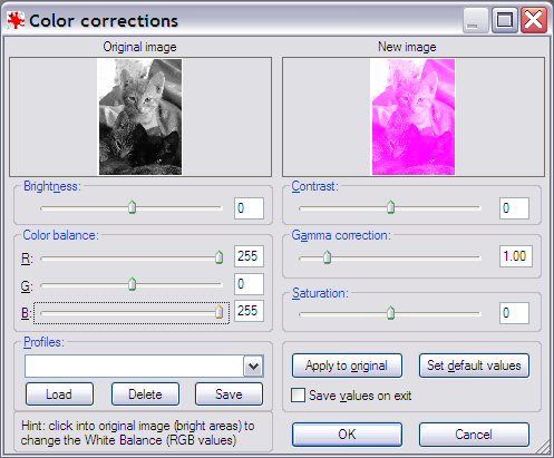

Turning off ICC (or other CMS) allow for direct mapping of "computer" (additive) colors (red, green, blue) to "printing" (subtractive) colors (C, M, Y).
For our purpose it is essential to know direct mapping of CMY colors:
  • 100% Magenta is made from rgb(100%,0%,100%)
  • 100% Cyan is made from rgb(0%,100%,100%)
  • 100% Yellow is made from rgb(100%,100%,0%)
  • Background is made form rgb(100%,100%,100%)
In unmodified ink system it allow for printing with sole ink, eg. I want to test Magenta for starving and I draw entire sheet of paper with rgb(100%,0%,100%) (usual name: "Fuchsia"). And after disabling ICC/CMS in printer driver, entire page will be printed with Magenta ink (and only with Magenta).
Halftones are made as follow:
  • N% Magenta is made from rgb(100%,100% - N%,100%)
Eg: If I want 33% Magenta I have to draw it with rgb(100%,67%,100%).
Some examples maybe, grayscale image and it chromatic counterpart intended to be printed with BK ink from M ink tank slot:
View attachment 1551 View attachment 1550
And transformation made with IrfanView "Shift+G" command
(please note R and B values set to "255" instead of "0"):
I left rest of carts in their places. Nozzle print looks like this:
grayscale_photprint_mg5150-jpg.1455
Replacing C with BK will act same, but black point have to be shifted to rgb(0%,100%,100%) (usual name: "Aqua"). In most photo printers C and M are optimized to deliver superior halftones.
Replacing both C and M is possible (black point have to be shifted then to rgb(0%,0%,100%) ), but overall image will be to dark. This is because each of CMY colorants blocks 1/3 of spectrum. If BK is used instead any of CMY colorants, entire spectrum is blocked. If both C and M are set with BK, entire spectrum is blocked twice, leading to darkening midtones.
MG5150 is dye CMYK with "UCR like" CMY-to-BK replacement. Replacement is engaged when every of CMY colorants reaches ~60%. Chromatic colors are not affected with "UCR like" replacement.
This method may be considered as poor man's B&W printing, but it also allow to use partially damaged printheads (some non-critical electronics failures or particular color clogged).

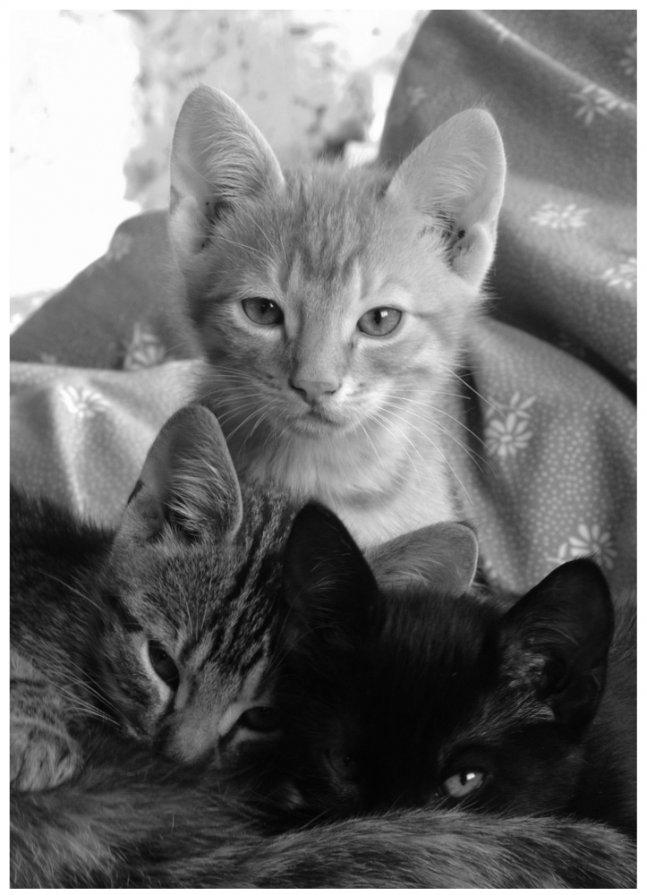

...Missing deep blacks and poor contrast.
But I will tweak my settings of conversion ...

@Lucas28 overall you have got a great blend of greys but but no cigar yet, I think the photo is just to washed looking, you need to add a bit of black into one or more of your carts, so keep trying. :(
Smashing looking motor dough.. :cool:

The photo looks better than the scan, but I agree that the photo black ink is missing.
Good B&W prints can be achieved with the grey dye ink, as I experienced with the Canon MG6250 which has grey in the ink set.
But the results with the K3 pigment ink is great! Reason why my latest experiments are with that ink.
