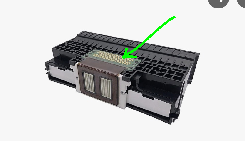

One thing I did not hear mentioned is checking for a good connection without contamination (crosstalk possibility) at the electrical contacts for the printhead itself, which is typically a pressure connection and more prone to problems (as shown in the arrow of the image).

A couple of items,
- Under unusual situations, ink or other contaminants between the round gold contact points can cause problems.
- Also, if the pads are no longer gold (gold coating), a good solid electrical connection becomes much less certain, as when the gold is gone, the underlying metal can and will oxidize and create poor conductivity. Gold is used because it does not oxidize.
I experienced this issue with one of my printheads' connection points, where many still had a gold coating, while others did not (I suspect the ones without gold may have been the ones that carried the most current).
I'm not sure if this is your problem yet, but it's worth ruling out.
It is more likely to happen if the printhead was a salvaged or remanufactured unit, so not just pre-owned yet pre-worn out.

I don't think it's a problem with the contacts. For one thing, it's very strange that only magenta has issues. There’re about 80 contacts on the printhead and one row of nozzles per each color. I don’t know how many nozzles has each of them, but the Pro9000 has 768 nozzles per color. On the Pro10 it must be the same or more. That makes a minimum of 7680 nozzles controlled by 80 contacts. It makes sense that the failure of just one contact would affect the output of dozens of nozzles on different colors.
Besides ( and more significant ), nozzle tests don't show the issue. We see it only printing large areas of solid color. All this points to ink starvation for one reason or another. Considering that a new OEM cart didn't fix the problem at once, my money is on partial and progressive clog of the internal ink channels, possibly because of suboptimal third party ink and maybe other factors like not printing often enough. ( I'm just speculating here, the OP. didn't say if the printer hadn't been used for some time ).
