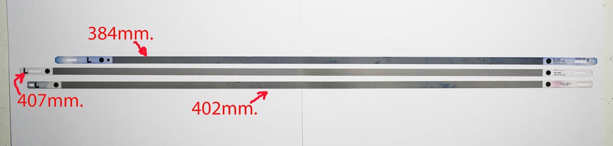

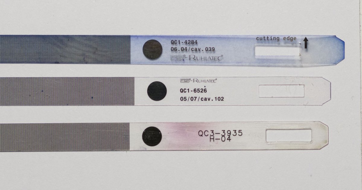

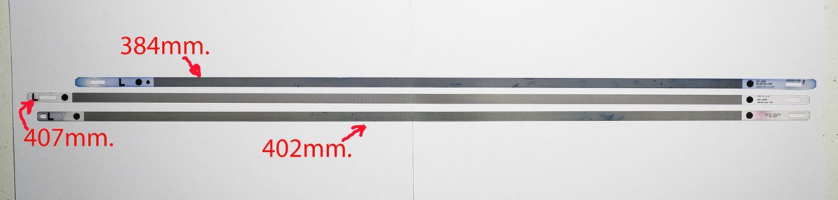

There’re Ebay vendors from USA selling QC-3927 spares, either new or used. Prices, as I said before, are absurd (35-45 Euro) if we consider the manufacturing cost of this strip of film, probably less than 1 Euro/USD.
If you measure accurately the length of your strip, there’s a remote possibility that one of my spares would fit your printer. The key question seems to be the length of the stripped part and the position of those black dots at both ends. See in the pictures what they look like and the length of each.
View attachment 9942View attachment 9943
Hello Artur5,
thank you for your replying . The stripe I do have is 36,8cm and the Dot on the Right side is 2,15(17)mm away from the last line. Best to you

As you said in the other thread, Error 6000 is for the disk film. Changing the strip film probably wouldn’t help. Also it’s unlikely that the disk is damaged, although it may be dirty, so there’s a chance that cleaning it would fix the problem, but it seems far more likely your suggestion of the purge unit.
Anyway, concerning the ‘possibly damaged’ strip film, @zapat should tell us the Reference of that part. It’s printed on the right end, The picture he/she posted it’s too small to see anything.
Part number is: QCX-XXXX where X can be any number from 0 to 9.
I have four spares from ‘deceased’ Canon printers, all different :
QC1-6526 - QC1-4284 - QC3-3935 - QC1-8293
The last one is for the A3+ wide Pro9000, too long for a MG5350 of course, but the other three are for A4 printers and none of them has the same length. I’m afraid then that only the exact reference will be of use.
Maybe searching Ebay or other places it can be found.
For instance, I entered QC1-4284 or QC1-6526 and found vendors on Ebay, although prices are very expensive, quite preposterous when we include shipping costs ( 40-60 euro total ), At this point probably it would be better to buy a new printer.
None of my former Canons were multifunction printers and there’s only a very small chance that any of my spare strip films would fit a MG5350 but if it were so, I’d send it to him/her for free of course,
Regards and bonne chance.
