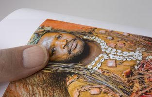

Thanks to your expertise, my printer now has fewer blockages and is in better condition than ever before. This leads me to question the necessity of aiming for absolute perfection. Perhaps the current state suffices. I wonder if the difference between prints with slightly defective ink and those under perfect conditions is even detectable.
Your knowledge has been invaluable. Thank you once again for sharing it with me.
