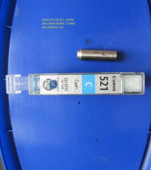

Picture shows the little tool with cart with hole in label. Commercial ones exist for cutting leather/material etc. I also use a Swann Morton surgeons knive, if you rub your finger around the hole to highlight it I can run the VERY SHARP BLADE around nearly as well. Swann Morton products usually available at Hobby/Medical/Craft outlets.

If the "well" the sealing ball sits in is not damaged I think it doesn't matter if the hole in the label is not perfectly clean cut. I think the punch is safer to use than knives etc. Searching the web I have found punches of 5 and 6 mm size, but no 5.5 mm size. Would any of these two sizes be suitable? And do you tap the tool lightly with a small hammer or press it against the label and twist it to cut the hole?

The larger plugs don't seal at the top. They seal internally at the bottom of the tunnel. As a result, even if the hole was not clean on top, it does not matter.
If you use a hobby knife (Xacto type) and pierce the label at the indentation, you can cut on the inside of the hole and use the hole sides as the guide. Quite easy and clean.

I use a small hammer, 6mm would be better give a larger clearance around the hole. The label is very thin so some cuts are cleaner than others. As Mikling if the hole is undamaged the ball seats a lot lower down and usually goes in with a nice click. My punch was homemade but I have a larger 10mm which has smaller shaft of about 3/4mm. This type could possibly be held in a drill chuck and rotated but this is a bit of overkill really.
The main aim of the punch was to get a clean hole and not cut any of the plastic around the hole which you can easily do with knives, particularly the large Stanley type. If using a knive I only use the surgeon type.
