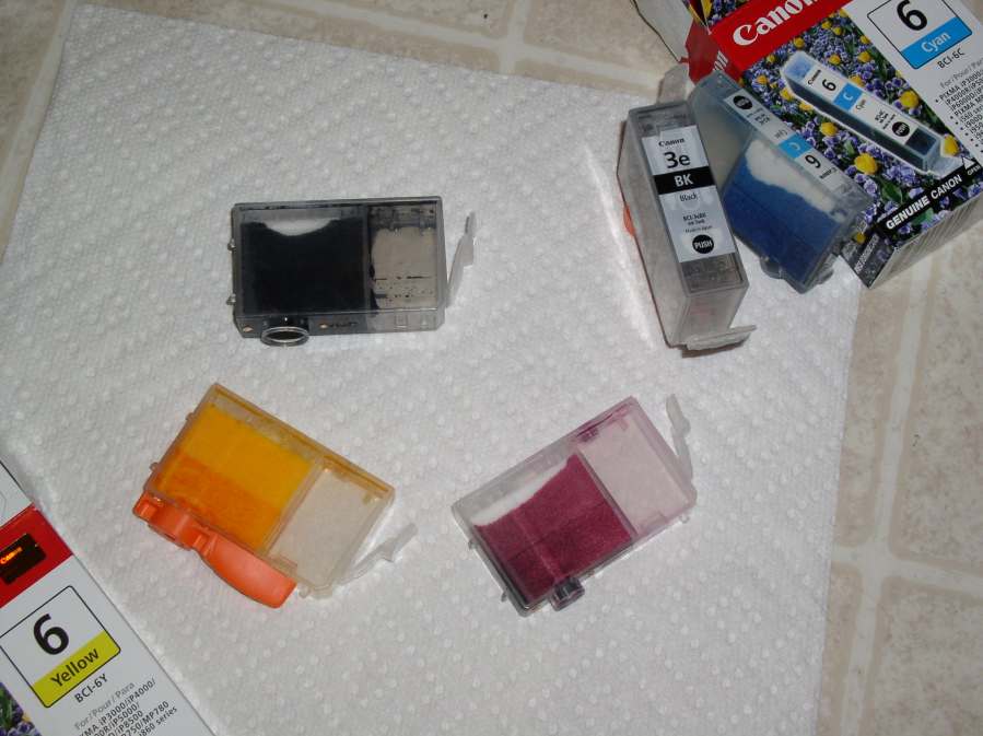

I did a search here on the subject but so far haven't found the specific info I'm after -- particularly new thinking on purging Canon OEM carts without creating holes below the ink line. I have a few ideas...
I have a collection of OEM BCI-3e and BCI-6 carts that have been sitting in my recycle bin for one or two years now. Now that the refilling bug has gotten me I'm intrigued about the possibility of resurrecting them, providing it can be done with a minimum of hassle. Otherwise, I'll just buy some new compatible carts or refill the carts currently in use before they are empty and need a purge. I'm impressed by the quality of Precision Colors ink for my Epson and plan to use this vendor's Canon-compatible bulk inks, too.

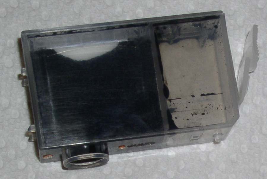

So these empty carts have all dried out. The PG blacks look worst, as they appear to have dried clumps of hardened pigment that may not readily dissolve during flushing.
The color carts have no dried clumping and the dye residue is very thin and looks readily dissolvable -- although some of them have a fully saturated sponge missing the typical white area at the top.
One advantage to having a dry, empty transparent plastic cart is the ability to see the ink path design. Looks very simple: ink reservoir at one end, with a small passage on the bottom leading to the sponge/outlet section. A very small vent on the top of the sponge section serves as a vacuum break during printing, but is small enough to prevent leakage or siphoning out the print head. Theoretically, all one must do is fill the ink reservoir and also saturate the lower part of the sponge, ensuring there are no air pockets and the laws of physics will take over from there, once installed on the print head. But have to clean the dried up carts first...
Here is my idea for flushing: Why can't I simply drill a hole at the top or upper region of the sponge side (in a spot where it won't interfere with the vacuum break vent, the cart's structural integrity, or cartridge retainer); remove the factory fill hole ball; and use some method of pressurized water or solvent to induce flow though the bottom print head feed port and out the top holes? Flush until the sponge and reservior appear clean and then pull a vacuum out the bottom to remove most of the sponge's moisture; then let it air dry for a few days until no condensation remains and then refill as I speculated in the previous paragraph, sealing the fill and purge holes on top when done...

The most important thing is to put empty cartridges immediately after the ink run out into a air tight sealing food box (type Tupperware or Curver) and even better: to impregnate the ink outlet with 15-20 drops of the following solution: 3 % glycerin, 20 % isopropyl alcohol and 77 % distilled water and let it absorb completely. The will keep the sponge material in optimal condition.
You can use this same solution to loosen the pigment material inside the ink compartment as well in the sponge (using the German Durchstich refill method). The next day give at a moderate shake to loosen the ink (mind the ink drops !), remove the solution and blow out the solution until the cartridge (both ink compartment and sponge) is dry. Repeat if necessary with a second rinse with this solution. If the sponge is still a bit moist, that doesn't matter. Now refill with your favourite ink. This should do the trick.

The color dye-based are pretty easy to recover, but the black pigment can be a bit more of a challenge.
