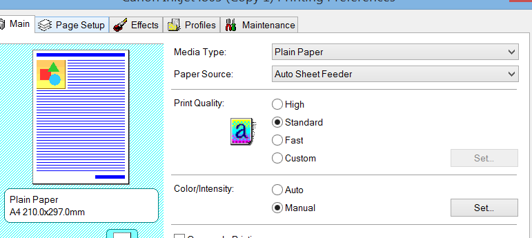

@russell, when printing in B&W, there is no need to first convert your photos over to greyscale, you should select photoshop to print in greyscale and let the print driver do the rest for you, but if you set your printer to use plain paper then your limited to only the PGBK black cartridge.
By doing this you mis-out on all the grey tones that can be developed by the other colours, your current setting will print, but only course black dots with little or no halftone.
Try using this Girl test sheet to get good B&W prints using all the colour range that your printer can provide, to access the colour changes go to page Set-up / Color/Intensity.
