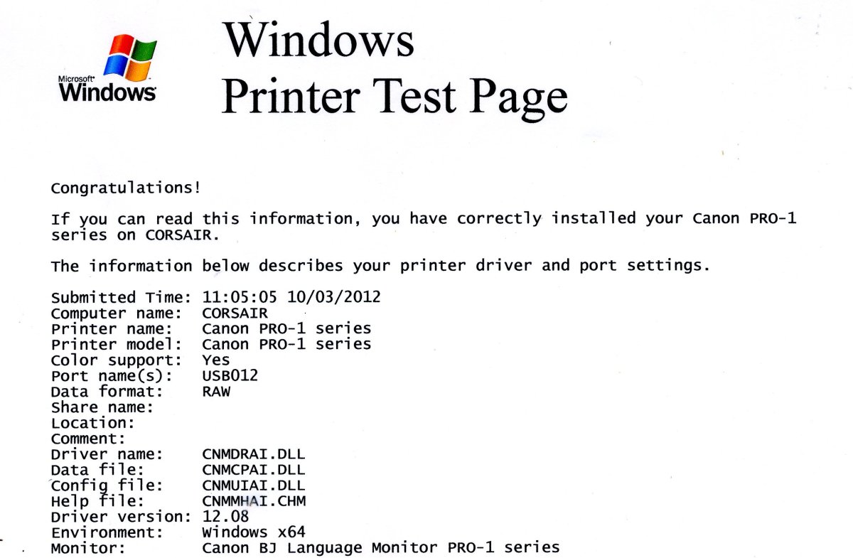

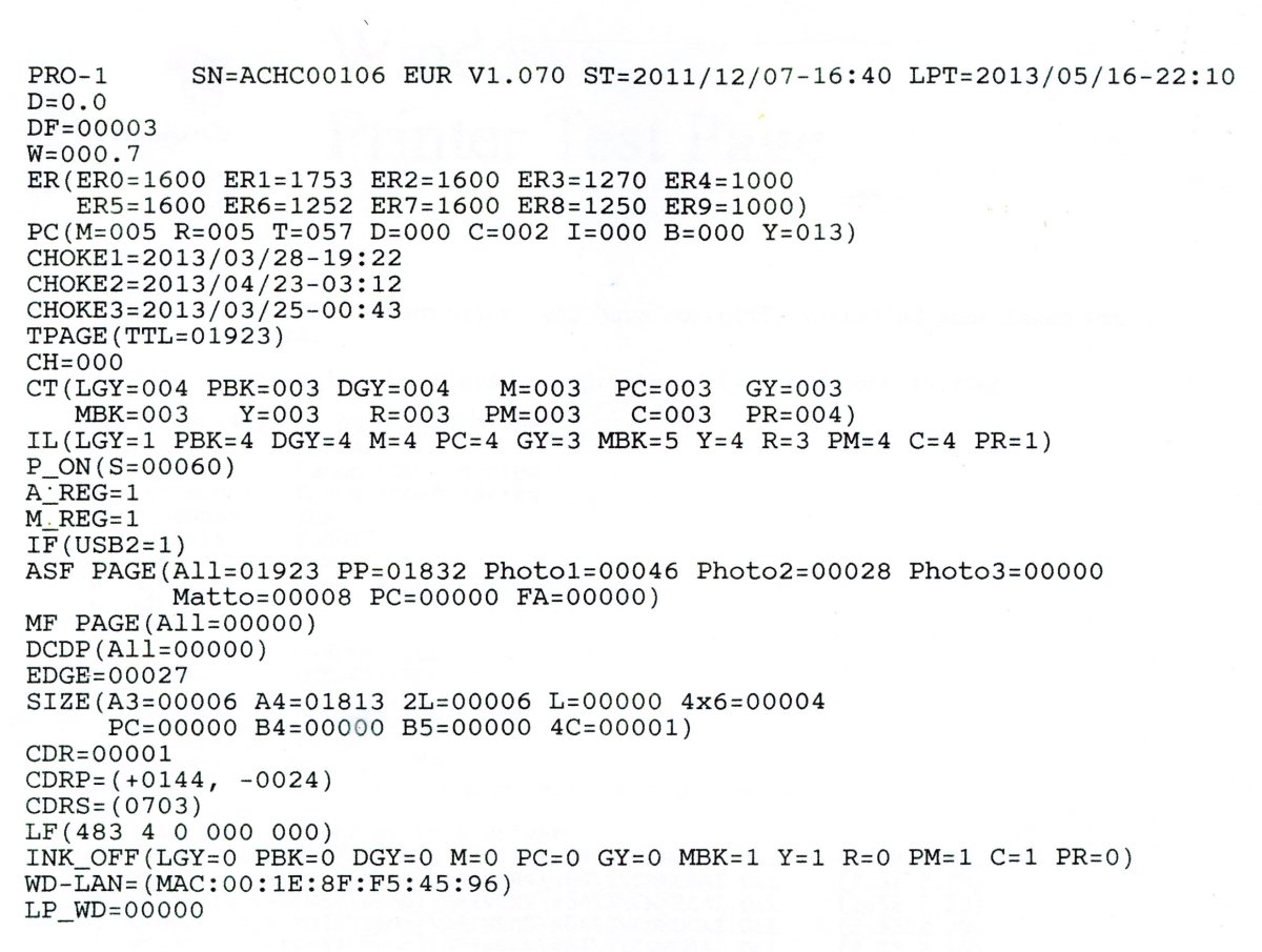

Nope @palombian, your incorrect on most of that, the EPROM chip inside the Pro 1 must have some residual power to maintain its active memory functions, when it loses power, that section of memory is also lost, and can only be reprogramed with the necessary coded file..
Secondly I did have a proper functioning service tool (V3400) at that time and was able to carry out the necessary changes that I needed, and only later did I remove the top cover to install the Printer Potty..
When I originally took the printer to the Service Agents, they couldn’t reprogram the printer, because they didn’t have the file on hand and had to requested it from Japan, I was actually present at the time, otherwise I wouldn’t have believe it either.. So no spoofing on their part..
Here is the first test sheets printed and the reset waste ink % counter, using the service tool..
View attachment 13589View attachment 13590
click to enlarge..
I believe you, but what is true for the PRO-1 doesn't necessary apply to the PRO-10.
