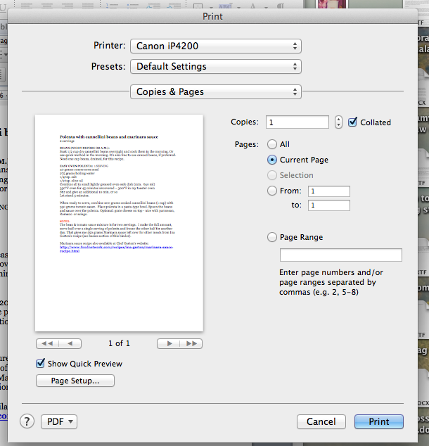

One additional question: Is it hard to set my printer to use greyscale? I've looked and can't see a way to choose that option, using the printer utility settings. In case it's relevant, I'm on a MacBook Pro, 13 inch early 2011, processor 2.7 GHz Intel Core i7 with 8 GB memory. Operating system is OS X 10.9.5.

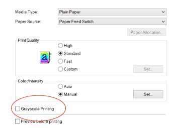

@apprentice, If you mainly only use B&W then a little Mono Laser printer would be best for you, and as I don’t have print Properties for the Mac to hand right now, but I imagine this Pic be ok, and if not then I’ll dig one out for you..

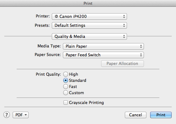

Thanks! That option missing in my initial print screen. Persevered and found grayscale printing via the drop down menu Copies & Pages. Yay! Now all I have to do is figure out how to make it the default. See screen shots:
Screen Shot 2018-04-17 at 9.41.14 AM.png Screen Shot 2018-04-17 at 9.49.39 AM.png

Open this tab again and click on greyscale and save it, then it will become your default setting...

Thanks again! Doesn't seem to be that simple, or I'm just being thick. Seems to make it the default for the particular doc, but not for all printing on iP4200. Still have to make the switch to grayscale every print job. No worries though. I have a friend who's the past president of the local Mac group in town. He'll get me sorted on that aspect. And appreciate the earlier suggestion for a Mono laser printer. Cheers!
