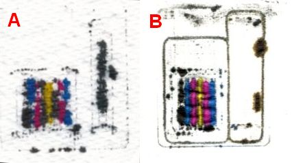

Did the stamp test show no pigment black like in "B" in the image?
If so then cleaning might bring the pigment ink back, If the stamp test looks like "A" and no pigment black is printed, then there is an electronic fault in the main/logic board and/or the print head. Only a new print head might then bring the printer back to working order.
But when a Canon print head fails electronically it might damage the main/logic board. A logic board damaged in this way might damage a new print head. So replacing a damaged print head is a gamble, and swapping print heads between printers for troubleshooting is risky.
How does the nozzle check and possibly a stamp test for the "new" iP 4200 look?
Sometimes an electronic fault in a Canon print head can begin as an intermittent fault and later become permanent. This could be the reason for the strange reset procedures to revive a print head sometimes seen on YouTube and on the web.
When cleaning a print head with water or other cleaning fluid, it is very important that the print head is completely dry before installing. Else moisture can create a short circuit or leakage current that can ruin the electronics in the print head and logic board. See this post.
Yes, it's just like B.
Do you believe soaking might not have cleaned my original head (and somehow even made it worse)?
Also, this Regular/Deep Cleaning business gets me nervous. I almost thought I burnt the nozzles the last time because, as I was talk later, doing too many of them (especially without ink coming out to cool them) will fry the little guys.

If cleaning the print head didn't bring back the pigment black in the nozzle check and in a new stamp test then more print head cleaning is needed.
How did the new iP4200 print before starting cleaning the print head?
I guess most Canon users on this forum think that deep cleaning is to be avoided, especially more cleanings in short intervals due to stressing the print head.
