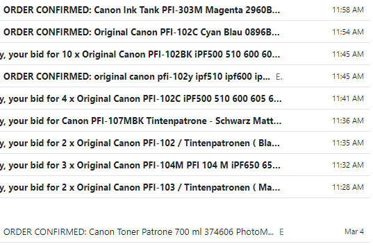

Thank you for the info. (Mr. Fingers also mentioned the bronzing).
As I shall be printing on Matt paper (only), my understanding is this potential problem does not apply (and I don’t require Chrome Optimizer or Photo Black Ink … as far as I know).
According to your experience, this ink sounds good (if used on Matt paper).
Longevity and fading are of interest. If I sell a print, fading is not an option.
Note – following previous advice on this forum, I have already started purchasing outdated OEM ink (in the wrong containers).
I suppose you mean Lucia EX inks for large format printers.
Although the PRO-1000 uses Lucia PRO - a later development, with probably smaller (resin encapsulated) pigment parts - chances are big the EX overall quality is better than Inktec.
I have no problems with these inks in the PRO-10, being of older date, but verify your nozzle checks meticulously !
