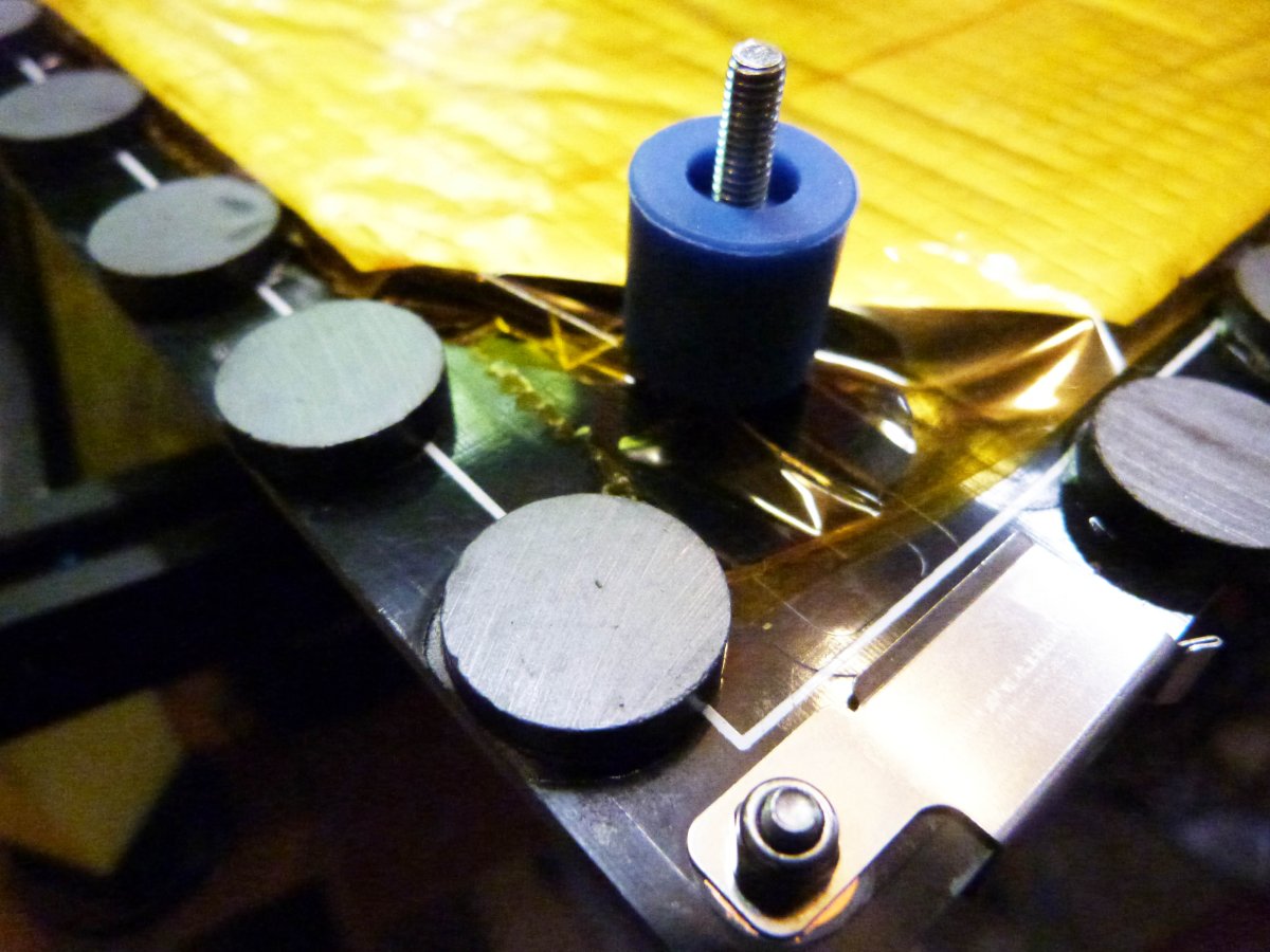

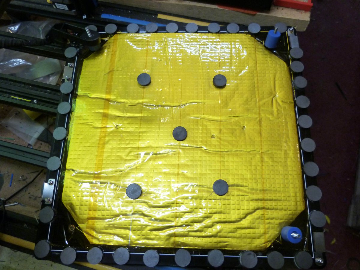

I won’t be able to test out my idea just yet, because the PEI plate is still in the post and will be for another 7-10 days yet, but as you can see the magnets on the edges of the hot bed should be as good as any adhesive sheet.
If not it’s back to square one..:barnie
View attachment 13856 View attachment 13857 click to enlarge..

I got a chance to spend the day with my 3D printers to install and try out these new PEI sheets..plus Silicon spacers and magnets..
As seen here I put on these silicon spacers in place of the usual springs, and to be honest they do hold the bed a lot more stable and firmer, (No wobbling) but there’re a bitch to get the hot bed level.
I wasn’t very happy with them at all, and I reckon they also expand a little during use from the heat of the hot bad, so it’s out with the new and back to the old springs, and my verdict on them is I didn’t find them very versatile and not worth the trouble using.
Now on to the PEI sheets I tried holding it down with about 35 small magnets all around the edges of the hot plate, but the level of adhesion I was getting was not very good and had to abandon that idea as useless.
So I was forced to use the self-adhesive magnetic sheet, but wait for it.. Because this is the best bit, so instead of applying it to the hotbed I stuck it to the Feckin original glass plate that came with the printer.
As the new PEI sheet wouldn’t stick to the hotbed, with all the little magnets on it, I had to use my old glass plate again which I had just stick the magnetic sheet to, now finally I was cooking with gas, then I spent ages trying to level the bed with the new silicon spacers.
