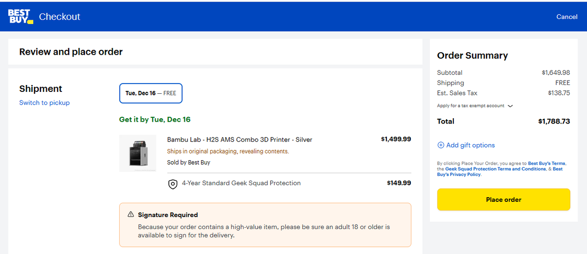

I CAN have nice things, right?!?! Pulling the trigger on a Bambu Lab H2S
It's in stock and I can get it in two days!
I don't usually buy extended warranties, but 4 years for $150... even if it's a false sense of security, karma is worth it to me.
I'm so nervous to pull the trigger, especially because the P2S with the combo is about half as much.

I think the standard Bambu warranty in the USA is 12 months? So you are buying 3years extra for $50 per year. To me this seems not unreasonable but it may be worth checking the terms and coverage as IIRC Bambu limits certain parts of the package to 3 months. It may be that the extruder and AMS have a shorter warranty - 3 months?
That's a great perspective, and basically how I was looking at it. My local BestBuy is right down the street, so it's good to know if I have a big problem (with the main board, main parts, etc. that are much harder to service than my cheap Enders), I can just bring it in, and make it their problem vs. working with Bambu, shipping, etc. etc. etc.

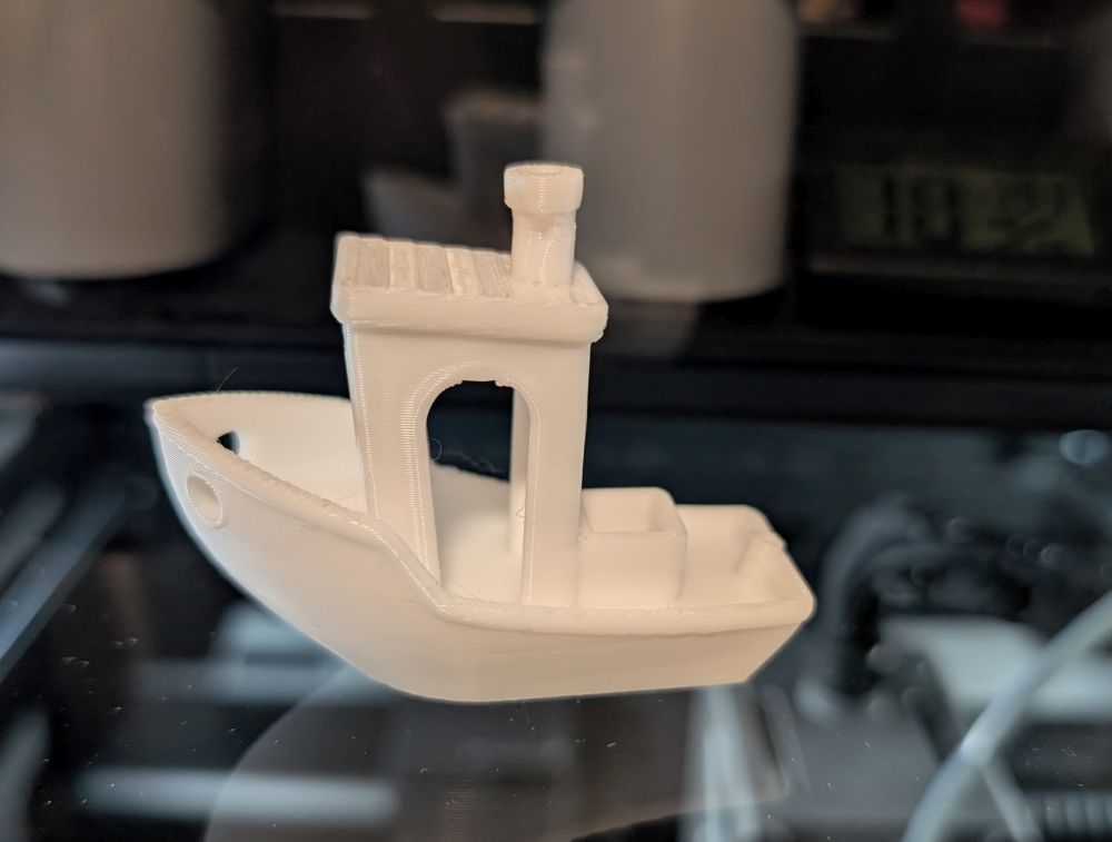

  1. Wow... it just works. The first model (my very first Benchy in 10 years) was right from the printer, and the next 4 prints were from my phone. The next 3 prints were downloaded into Bambu Studio.

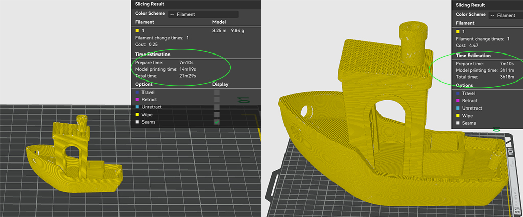

Again, I've never printed a Benchy before, but since it was on the printer and I thought if I was ever going to test quality, this was going to be the time.
11 minutes in ludicrous mode. Quality is pretty perfect!

Your WOW experience is exactly what I had with the P1S and still get when a print comes of the plate. I am sure over time you will come to find the odd feature that you wish was different but I am pretty sure your experience will echo mine with Bambu
