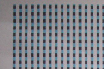

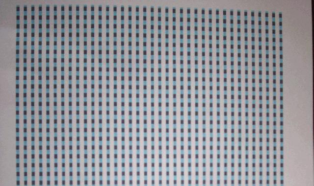

UPDATE:
Well, after soaking in water for a couple of hours, and standing on a pad wet with methylated spirits overnight, I put the head back in and the printout still wasn't right, but I couldn't tell exactly what was happening.
So I created a test page of my own - a page full of 8 pixel wide vertical black lines, with about a 10 pixel space between the lines.
Now I can clearly see what is happening, but I don't know what it means in terms of head blockage or whatever.
There are alternate bands of black and cyan the full length of the page (see below). Perfectly regular. To the naked eye every band (both black and cyan) is the same width - about 2.5mm in height as best I can measure.
Any ideas?
TIA
- Billy

If your printer is anything like mine, the pattern you are getting would mean you are telling the printer that you are using photo paper. This would also be confirmed by your comment earlier concerning 6-Black. When printing 100% black on photo paper, my printers use photo black, cyan and magenta. I'm guessing that your printer is not printing any magenta and half of the photo black nozzles are not printing. This is not characteristic of an ink flow problem but rather an electrical problem. All it takes is for one of the signal paths to be interrupted for this behavior to happen. If you have one of your other replaced print heads and it behaves the same way, I would conclude the problem is in the printer and probably cannot be fixed, but maybe you can find a loose connection somewhere.
What happens if you tell the printer that you are using plain paper?
What does a nozzle check look like?

Soporose,... There is a much better way to figure out what your printhead is doing than the test print you created. I looked at your print results and like ghwelljr indicated, it does not give you any clear information. The BEST thing to do is to go into Service Mode, and then push the Resume button once and then the power button. This will print the "Service Test Print". It is 100% better than the the nozzle check and it has much more data. One of the sections of my new Manual goes into detail to explain all of the information that is contained in the Service Test Print. The is the first thing that Canon Service Tech do when the get one to repair. The top lines of text tell all kinds of things but the "D" value is the percentage of waste ink that has been dumped.
The crosshatched lines in each of the colors, including pigment black and Dye black are detailed tests of each print nozzle one at a time. It is clear enough so you can see exactly which nozzles are printing and which are clogged. It could not get any better or more detailed than that. I use a 10x hand magnifier to examine the print. If you just look at it everything may look fine, but when you examine it under 10x you will see some nozzles that are not printing. Because this is so important, I used this as an example in my Manual and included a test print for the i860 that at first looks just fine. Because the Manual is in pdf format, and the images that I included are very high resolution, it is easy to magnify this to 500% (5x) in Adobe Acrobat reader. At 5x you can see which nozzles are bad.
Remember, the printer has banks of nozzles for the Cyan and Magenta. One for regular Cyan and the second set to simulate Photo Cyan. In the Service test print you will see 1 large set for pigment black, 4 patterns for Cyan and 4 sets for Magenta, two for yellow, and finally two for Dye black. Why 4 for Cyan & Magenta, because there are 2 each for regular Cyan and 2 each for Photo cyan nozzles. These printer are also capable of micro liter ink dots, so the second bank of patterns is testing the picoliter ink dots. So there you have it. As an Engineer, if I wanted to design a test pattern for my printhead, I'd make a pattern that would easily show the ability of each and every nozzle in the printhead to draw a short line. Canon does this two ways. Each of the crosshatch patterns is generated by the same stored timing signals. As an example, let take the Black pattern since it is much larger and easier to see with a naked eye. The pattern starts by firing EVERY nozzle in the black printhead at the same time. This makes a vertical line which is the left edge of the crosshatch. The number 1, 10,20,30,40,50,60,70,80, etc. nozzles fire for "N" millimeters. This makes horizontal lines "N" millimeters long. Then ALL the nozzles fire once again and this creates the second vertical line. Next the number 2, 11, 21, 31,41,51,61,...etc. nozzles fire for a period of "N" millimeters. The pattern repeats until EVERY nozzle in every bank has fired. This creates the total crosshatch. It demonstrates that each nozzle will fire and print correctly and not sputter or spit, or smear, and it demonstrates the nozzles will fire at the exact timing signal and turn on and off to create exact size ink dots in the perfect place. If you wanted to know what your printhead is doing, this is the best test.
The remainder of the Service Test print is about accuracy in placing very straight lines in exact positions. It also checks how the printer registers paper and aligns the paper to print and that it starts and finishes the print in the exact position of the paper. It also tells the Canon Service tech just about everything you did to your printer after you last left them, and exactly how many pages you printed, what kind they were, which were black, which were color, which were photos, etc. etc. etc.
Also, I don't think you let your printhead soak enough. If you do a test print and you don't get each crosshatch to print, you need to do more cleaning. Of course it could still be that you're not getting the ink to the printhead to begin with, and this could be bad ink carts, or a bad purge unit. If you ever take the printer back to the Canon Service shop, make them print a Service Test print for you before you leave. Then you know you have a good printer.
