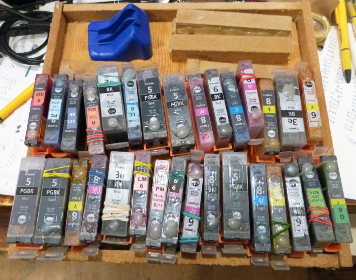

I don’t do anything special with my old dye cartridges and leave them in a wooden tray sometime for years, they are there when I need them.

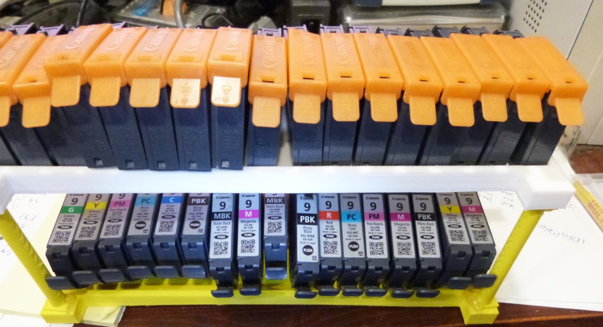

On the other hand, newly filled pigment cartridges are stored upside down, while the next sets to be used are all right side up, its a handy way of keeping track on them...

In your self-made 3D printed cartridge holder!
Yes it is, and I would have made one for the dye carts too, but there’re so old its not worth it, beside the wood tray is more than adequate, and if I ever make a toilet roll holder, I'll send it to you... ;)
View attachment 6724 View attachment 6725 click to enlarge.
