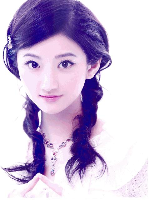

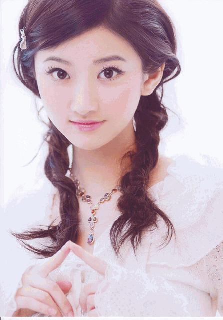

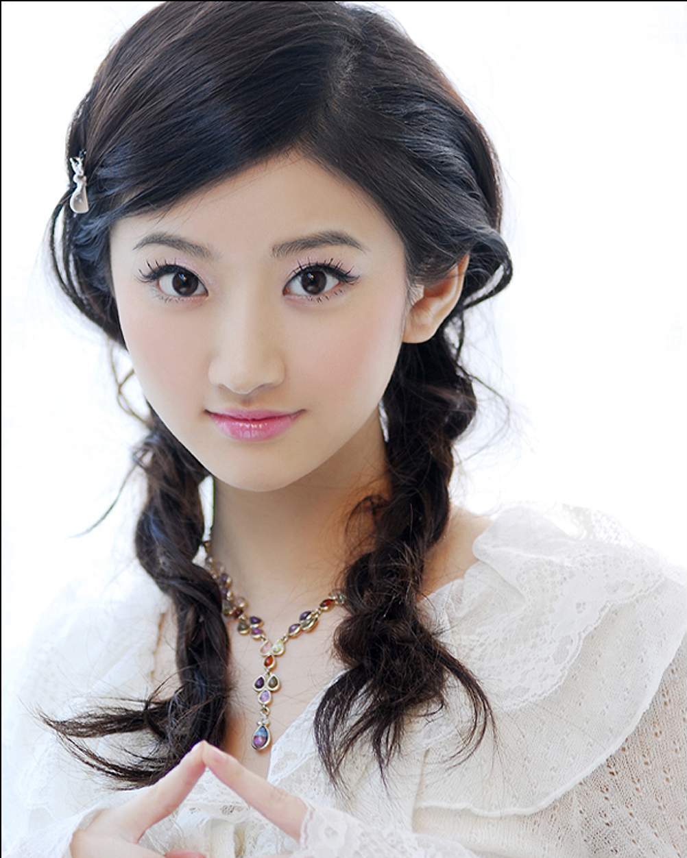

for Grandad and hpnetserver:
Here are things I did today: I change the whole set of cartridges using original canon cli-8s,
ok now I get them all in order, they are like this:
first one is the original, 2nd one is my local ink, third is from canon OEM cli-8, I replaced all 4 cartridges, and the forth one is printed from my hp 952 using the hp 78 color cartridge (refilled).

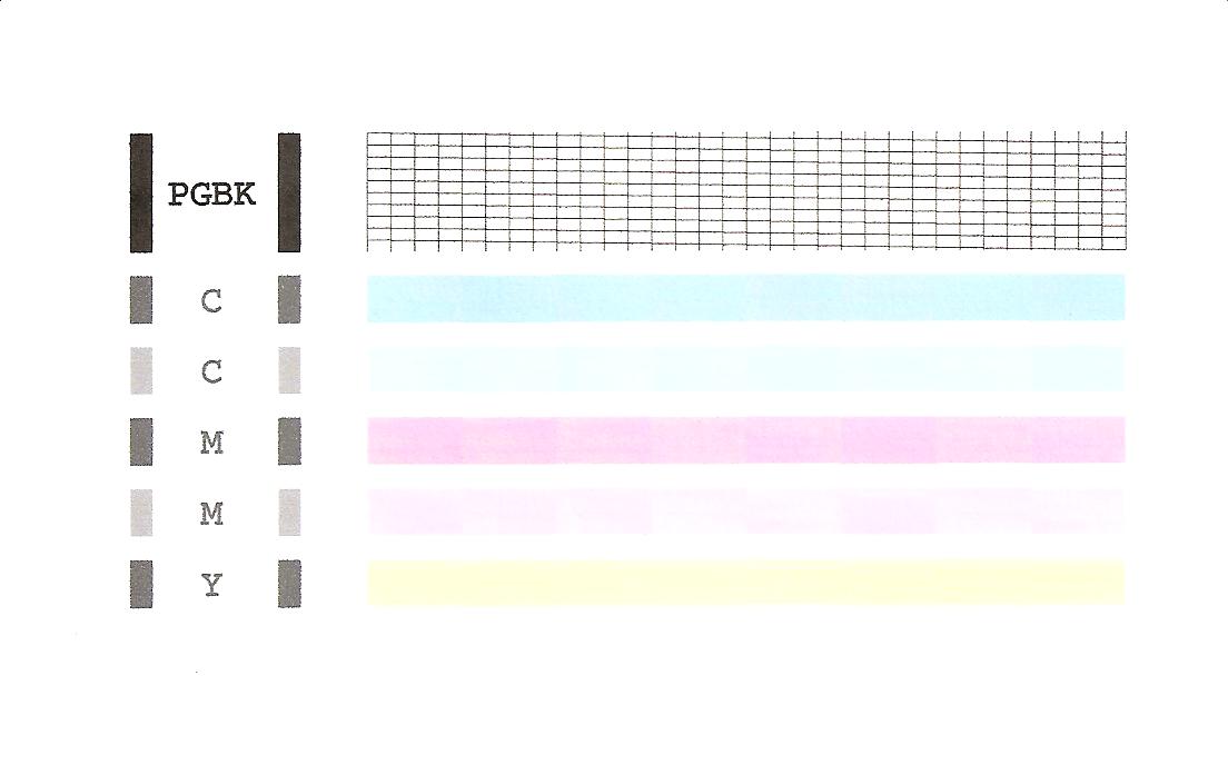

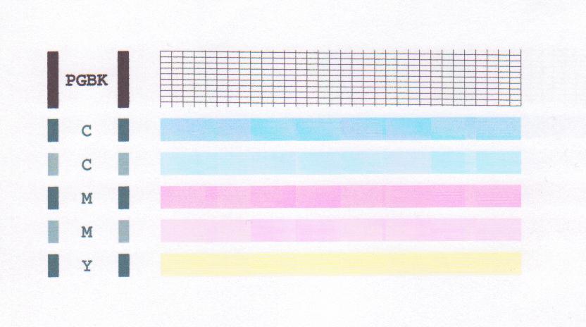

on the second row the first one is the picture printed from the OEM cartridge scanned by a canon 150 scanner, the second one same picture scanned by a HP3180 psc.
the nozzle check are the same printout except scanned by the two scanners.
as you can see there are quite a bit of difference in each ink and scanners. I wonder both you experts can tell me anything wrong with the printer or print head. These are all letter size pictures printed on kirkland photo papers.
except the one printed by the hp952 is 4x6.
oh here is a last one I used G&G competable (all 4 cartridges)

Hi, hpnetserver,
if you click the first scan, it will go bigger, and if you click it once more, it will go even bigger, and all the broken line will show solid and I think that is a better picture than the 2nd one.

Itsang,
Much of this mirrors what hpnetserver already said.
1. The nozzle checks look normal.
2. The differences between the two scanners are obvious, and show why we can't make any judgements about color based on these scans.
3. In spite of the scanner problem, the hair in the image printed with the OEM ink certainly looks "blacker" than the one printed with your "local" ink. Is this what your eyes tell you?
4. The OEM ink printed image appears to be lighter than your original. What do your eyes tell you? This can be adjusted in the printer driver if it is close.
5. The conclusions about your local ink are obvious - look for an ink specifically formulated for your carts. Since we are told that CLI-8 inks are different from BCI-6 inks, make sure that you check this. Generic inks are usually a problem.
6. Any printer that only uses C/M/Y for photos will not be able to produce dark blacks as well as a printer that also uses a dye based black for photos.
7. If you want accurate colors with a bulk ink, be prepared to buy a custom profile for your printer/ink/paper combination.
