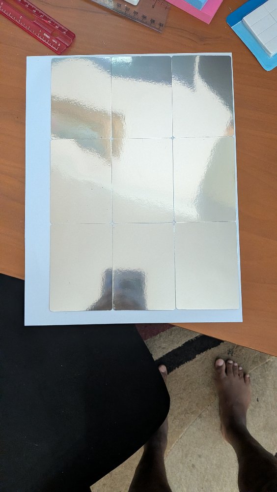

Long story short, I'm trying to sublimate ontop of acetone wiped foil digimon cards to make proxies and play. I'm able to achieve pretty good results in terms of detail, but when it comes to color I'm always a bit off.

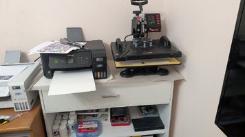

From the setup, I have a Epson ET2800 Converted Sublimation with ASUB INK, Printed onto ASUB Paper and using a Vevor Press

What I actually did is wiped 9 of them off and then taped them onto something structurally sound (like photo paper). Then sublimated onto all at once. The theory works but there are other kinks I need to work out.

1. Lay the Reflective Foil Cards onto a piece of paper and tape it down (image 1)

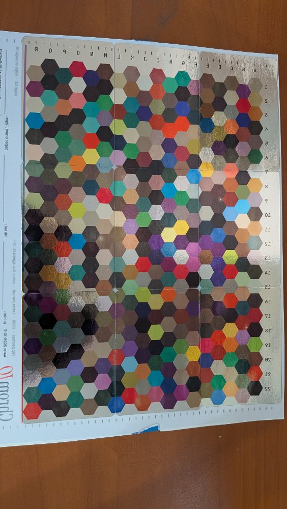

2. Set the Vevor Heat Press to 350 at 30 seconds (image 2)
3. Print the Targen Sheet (Chrom IQ Step 2)
4. Attach Targen Sheet to Paper using some masking tape
5. Sublimate (image 3)

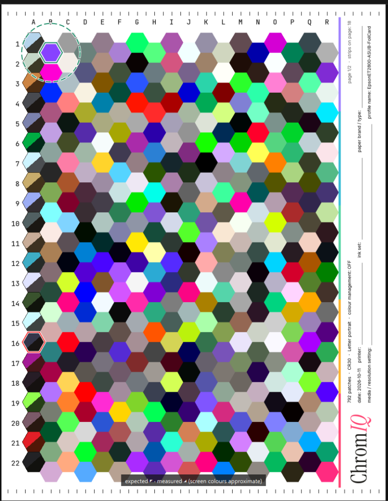

6. Measure using CR-30
7. See the measurements look weird on the ChromIQ (image 4/ ChromIQ Step 3)

I mean the measured patches do look pretty dark but still show their color to a degree. Could this work?
One thing that might be difficult for measurement either way are the tiny gaps between the cards I guess.
The problem is the underlying reflection of the metallic material (mirror), this throws a scattering pulse into the spectro, making it practically impossible to profile.
The only thing I can suggest (not ideal) is to sublimate on a white cardboard (something white and opaque). It is cheating because I presume there is no white ink. So white is actually is nothing printed: this means a shiny reflection giving a false reading in the spectro, destroying the white point on which the profile should calculated on/based on together with the black point (less of a problem). If the material is just white and opaque it would be fine, but this is almost impossible to achieve.
The other problem is that with light colours you can see the shiny metallic structure is shining through the colour patch while saturated colours are completely covering the metallic shine: there is no consistency.

The greenish look is the combination of the metallic material + yellow, which gives a shattering effect which is seen as a greenish reflection. This is inherent to the material you are printing on and cannot be corrected, unless there is a white layer on the metal material on which the yellow is printed on. The secret is: you need a white ink layer on this material.
