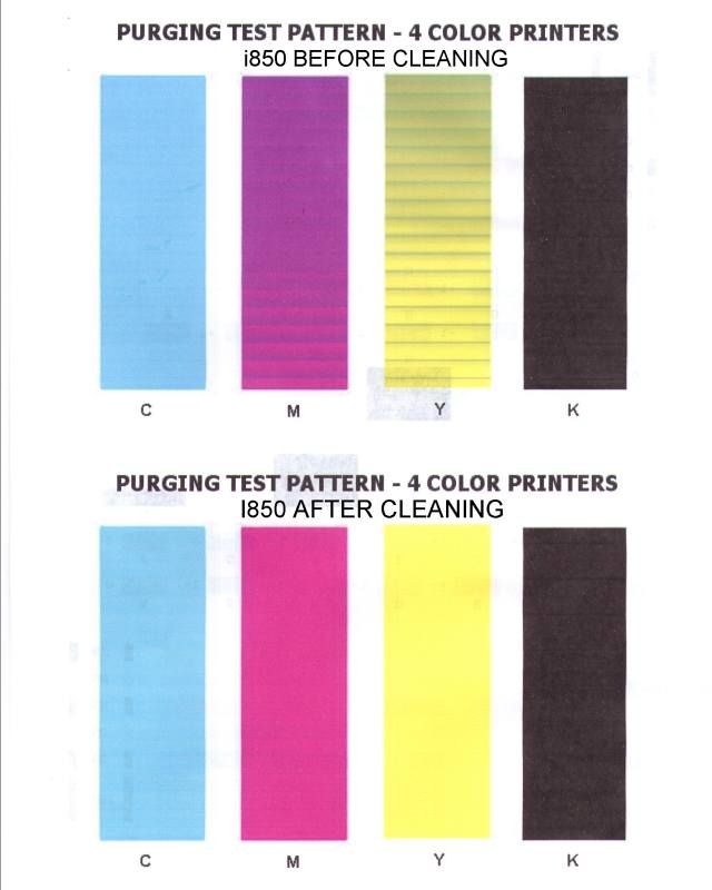

I searched the Inkjet Printer Forum for a condition that matches mine - cross contamination? This string discusses at length the symptoms, possible causes and cures.
My Canon i560, when printing a 4 color purge pattern, displays a banding pattern in the yellow and magenta color bars. Two normal cleaning cycles clean it up but the problem returns overnight. I suspect internal print head ink cross contamination.
I also have a Canon i850 printer which uses the same print head. I exchanged print heads between the two printers leaving the 4 cartridges with their original printers. The identical problem followed the print head to the i850 printer. To determine whether the rubber print head inlet seals are the possible trouble source I rotated seals C to Y, Y to M and M to C - no change. I noticed no excess ink around the rubber seals when the cartridges were removed. Since the print head is parked on a different purge pad, I discount the purge system as being the source of the cross contamination.
On this string: Chobo 2 , post # 1, pic 3 purge test pattern
On chobo2's problem, I concur with Phipham, post #4
This test pattern resembles mine except the magenta is contaminated with yellow but the yellow is clear. My yellow shows banding after a couple of idle hours. After a few more hours, banding shows up in the magenta as well.
My conclusion is a faulty print head. I don't intend to disassemble it so the best fix is a new Canon QY6-0064 print head.

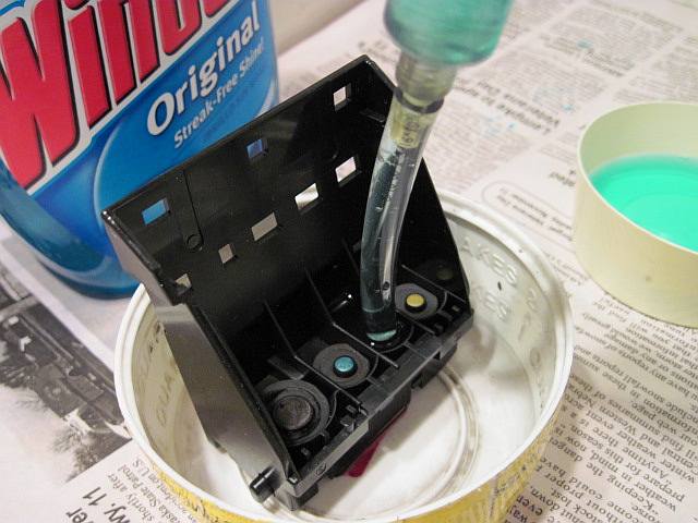

Here's what I've done: To avoid immersing the print head in water, I put a snug-fitting clear plastic tube over the print head inlet after removing the rubber gasket. Using a 10ML syringe that fit snugly into the tube, I slowly injected Windex into/through the print head forcing the ink out into a shallow container. When it flowed clear, I placed the print head on a four layer fold of paper towel and filled the plastic tube with Windex. It wicked into the paper towel in less than 2 minutes. I filled the tube 3 times and it flowed freely while I waited. I did this to the yellow and magenta inlets only because the black and cyan seemed to be OK. I removed the rubber gaskets around the color inlets and examined them under a magnifying glass. They are pliable and appear smooth with no cracks or distortions. I shifted them one color position when I re-installed them.
The cartridges were already fitted with silicone rubber plugs. I flushed the BCI-3 yellow and magenta cartridges with hot water using a 16 oz. squeeze bottle with a tapered nozzle. I blew the cartridges as dry as I could by mouth. I then filled them with fresh Hobbicolor ink. Before putting them in the printer, at your suggestion, a gentle puff over the vent hole ejected a couple of large drops into the sink.

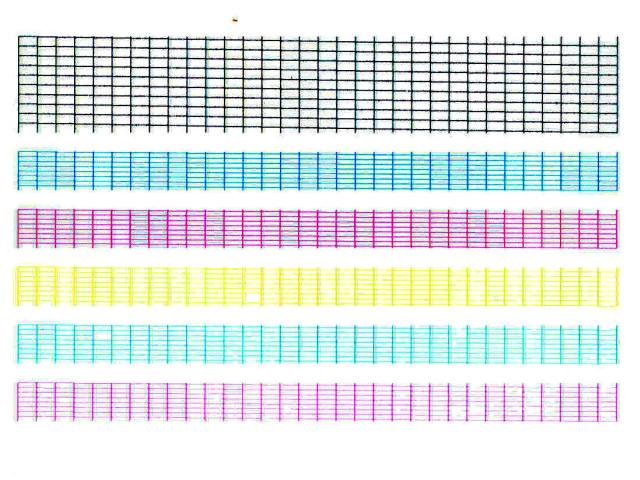

I installed the print head and cartridges in the Canon i850 printer and then did one deep cleaning and a couple of regular cleanings of both black and color. I did a nozzle check. I printed a four color bar chart using plain paper and standard quality preference settings. The first bar chart printing was at 10:25 AM, the second bar chart a half hour later.
The accompanying graphics show my print head cleaning method and the nozzle check. The first color bar is OK, the second has banding in the yellow. I scanned the nozzle check at 400 DPI, cropped the image and enhanced the colors. The yellow is not as clear as it should be but there doesn't appear to be any yellow nozzles missing. After a cleaning and a good bar chart print out, the second bar chart print out a half hour later shows the yellow starts with an orange hue which progressively diminishes to just banding stripes and then is almost clear yellow at the end. Three hours later I did the same color bar print out. The yellow bar was a solid orange at the top diminishing to shades of yellow interspersed with orange lines. The cyan was a lavender color. So it seems that within a half hour, without any activity, the yellow and sometimes another color takes on an unwanted hue. The results are the same with a solid yellow purge pattern.
Just for giggles, I put the suspected print head back in its original home, the Canon i560 printer. I installed the original i560 BCI-6 cartridges. After turning it on, the printer went through its thing which I assume to be a cleaning cycle. I then launched a service mode nozzle check. It looked OK. I returned to the normal mode and launched a color bar print out. The color bar looked perfect. After 35 minutes I did a second color bar print out. Now it displays the same orange banding in the yellow bar and this time there are white lines in the cyan bar. The magenta appears normal.
My speculation is that the yellow ink (and possibly others) is being contaminated within the print head by a slow internal bleed from another ink channel. When purged by a cleaning cycle or a four color bar chart print out, the yellow begins to clear up as fresh ink replaces the contaminated ink.

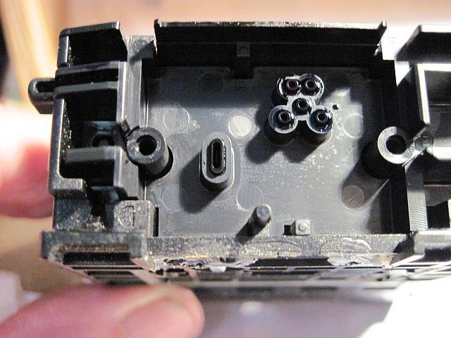

Canon i560 print head
This post describes and illustrates a method I used to fix a suspected slow internal leak in a Canon i560 print head. See post #25 and #27, this string.
Update: 3/14/2010 See post #44, this thread.

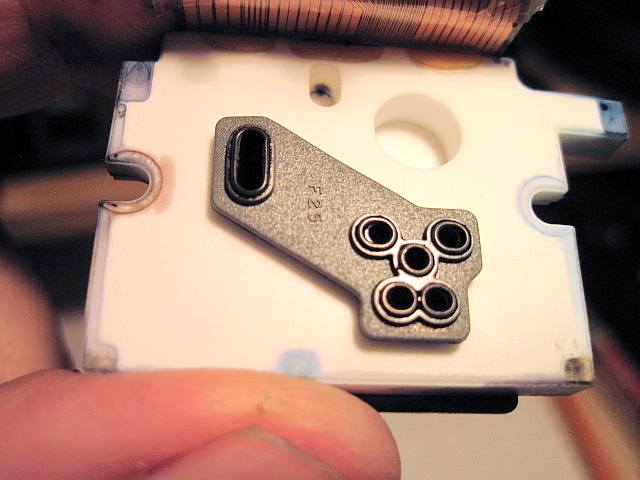

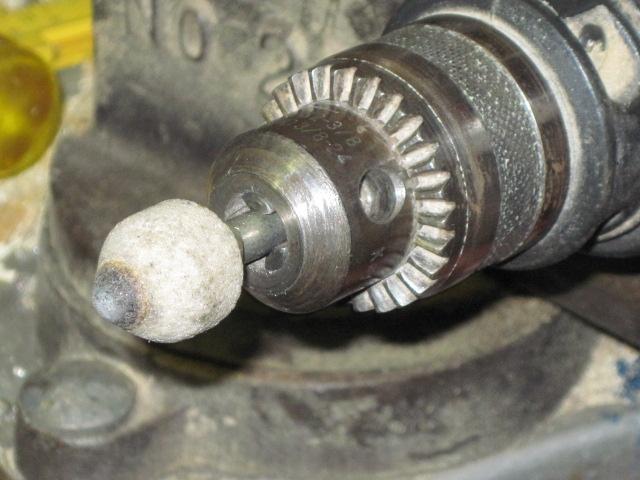

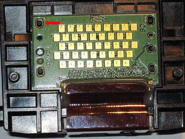

The PC board is fastened to the print head body by four plastic tabs at each corner. I removed them using a tapered grind stone about an inch in diameter. I acquired it many years ago and don't remember its purpose. It has a 1/4" shaft that can be inserted into a 1/4" or 3/8" drill chuck. I clamped the electric drill in a vice and set the locking switch to on. I carefully pressed the print head tabs against the point of the spinning grind stone and ground them away.
I removed the two screws holding the ceramic part of the print head to the plastic body. One of the Phillips screw head slots was buggered. To remove it, I had to exert a lot of pressure to keep the screw from slipping under the Phillips screwdriver. I used an Exacto knife to cut through the outside edges of the silicone rubber sealing the ribbon conductor. I gently pried the ceramic and aluminum wafer that houses the nozzles away from the plastic body of the print head. A rubber type gasket was exposed.
A close examination with a magnifying glass of the gasket and the two mating surfaces detected no damage or any sign of leakage between the color channels. I washed the gasket in hot water and examined it again. The gasket was very smooth and pliable. I then flushed the ceramic and aluminum wafer in both directions under a stream of hot water. I flushed the plastic housing inlets and channel openings that mate with the gasket in both directions also. I dried the loose PC board with a hair dryer. I then re-assembled the print head taking special care to tighten the two Phillips screws evenly. I smeared a small dab of epoxy (JB Weld) over the four tabs to secure the PC board to the print head body.
I installed the print head and cartridges into the original i560 printer and turned it on. The printer did its thing and stabilized. I launched a four color bar chart test. It looked OK. I waited a half hour and did the same thing. It looked OK too! This was the point where the trouble with discolored yellow appeared before. I waited an hour, same test. Still no trouble. The next morning I launched the four color bar chart test again. No trouble. I've printed out a few test charts, photos and some everyday bulletins of interest. No trouble so far.

Emerald,... First,..Congratulations on a job well done. You have more guts than most of us. After looking several times, I am beginning to believe that the "Pharmacist" is on the correct track. If you now have totally cleaned the parking pads, I don't think you will see the problem again. Sometimes the color park pad gets so LOADED with one or another color, such as Magenta, that the excesse ink wicks back up into the nozzles of the other colors. In your pictures we see the bar test printing out 4 colors and the yellow starts out with brown and gradually fades to pure yellow. The initial brown color is just the mixture of yellow and magenta ink only in very small amount. As soon as that small about is expelled onto paper the color return to yellow. In other words, as soon as the old "Wicked" ink is used up and NEW ink flows, the color become pure. If you really had any cross contamination in the head, the color would be bad and would get worse the more you printed.
I thank you for all of this documentation as it adds to the final understanding of how things go wrong and can be corrected.
I have done a lot of work with HP ink carts and many attempts to clean them once they get clogged. What I have learned is that resting any bank of printhad nozzles of any color in water or any pool of liquid will RAPIDLY CROSS CONTAMINATE ALL COLOR, ESPECIALLY THE TWO THAT ARE ADJACENT. Once ink "Wicks backward" in any HP head it is very difficult to get it out and can ruin the entire printhead -ink cart combination.
