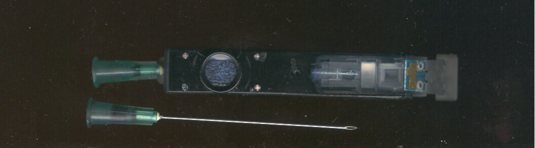

Hi OM2
Check out pharmacist's instruction for refilling PGI-520/CLI-521 cartridges with the German method. Link here: http://www.nifty-stuff.com/forum/viewtopic.php?pid=26249#p26249 It is a very good instruction. Specially note pictures 6 and 7 showing proper insertion of the 2" needle and stressing the importance of injecting the ink slowly. I recommend the use of a thin needle 21g, color code green. This helps insure ink is injected slowly.
I would suggest using this method, and later when you have made this method work well go on to the SquEasyFill bottles.
I have made a scan of a CLI-521 C cartridge with the 2" needle properly inserted, it might be a bit easier to see proper needle insertion:
I have not experienced the leaking you describe, but I have had problems with cartridges being underweight after a German method refill. After a flushing and drying of the cartridge it refilled properly again. Maybe your problems are also caused by sponges needing a flushing?
http://www.nifty-stuff.com/forum/uploads/6881_2_inch_needle.jpg
thanks for the reply - much appreciate
as far as i can see, i am actually following the pharmacist instructions - that's where i learned originally
i've looked closely. the needle is exactly where it should be. i can see the ink coming out and being pushed back into the sponge chamber without dropping into the chamber
i think what might help is if i shoot a video next time i refill to show u guys. i can't believe i'm doing something wrong!
EDIT: i seem to have found a solution anyway. i'll still send in a video for u guys to look at.
i suck the air out first and then refill. this seems to work nicely with no ink coming out
my guess is the cart is full of compact air and you can't push the ink in
