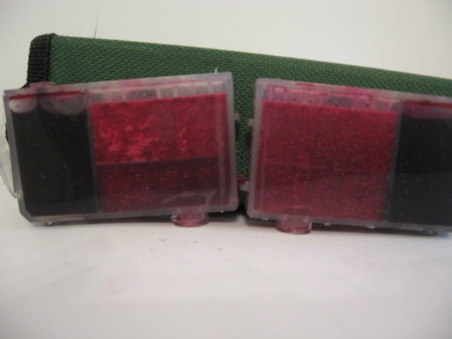

Gigigogu, I'm trying to figure out what might have happened. it appears that there has been ink in the space above the sponge. This probably means one of two things:
(1) You used pressure to force ink into the cartridge (you pushed on the plunger at some time, or
(2) there was a lot of ink in the sponge that foamed during evacuation (the cartridge wasn't empty when you refilled it).
You said there was "a lot of foam in sponge". When and where did you observe foam?
It is a bit more complicated. Yes, there was ink above the sponge but from multiple causes:
- positive pressure aka pushing the plunger in one or two instances
- there was a "preferred channel" for ink straight from bottom to top. This channel is visible in picture for both cartridges
- in the space above sponge it is created also negative pressure that may draw ink
Regarding the foam, when you apply negative pressure you draw air from hole cartridge, from spongeless side, form the space above sponge and from sponge. All this air is routed through bottom sponge that, no matter is was inkless or not at the beginning, it was filled after very first cycle.
So I observed the foam in bottom sponge and in syringe at "pull" part of cycle, starting with second cycle.

there was a "preferred channel" for ink straight from bottom to top. This channel is visible in picture for both cartridges - in the space above sponge it is created also negative pressure that may draw ink
Yes, there is a channel. For this reason I suggest holding the vent side up during the fill stroke.
I cannot see where the channel is in your picture. Is it where the lighter color is in my pictures that travel from the outlet port straight up?

The "channel" I am speaking is near the front edge of cartridge (opposite side of spongeless compartment). It is also visible in ghwellsjr pictures.
